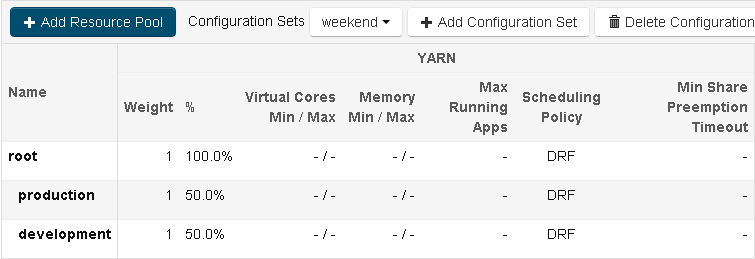

Example Configuration Sets
The weekday configuration set assigns the production pool four times the resources of the development pool:
The weekend configuration set assigns the production and development pools an equal share of the resources:
The default configuration set assigns the production pool twice the resources of the development pool:
See example scheduling rules for these configuration sets.

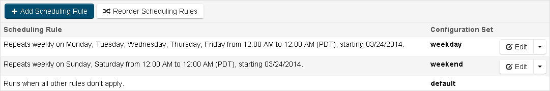

Scheduling Rules
A scheduling rule defines when a configuration set is active.
Example Scheduling Rules
Consider the example weekday and weekend configuration sets. To specify that the weekday configuration set is active every weekday, weekend configuration set is active on the weekend (weekly on Saturday and Sunday), and the default configuration set is active all other times, define the following rules:
