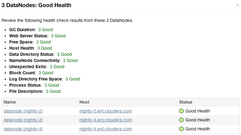

If there are multiple role instances (such as for DataNodes, TaskTrackers,
RegionServers) clicking
to the right
of the role's health
displays a
pop-up that allows you to select specific instances. Furthermore, this pop-up
displays the results for each health test that applies to this role type.
You can filter by an individual health test result. Click the result link -
an
appears by the link (as shown in the
illustration above) and only the instance(s) with that specific health status will
appear in the instances list.

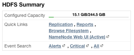

- The HDFS Summary shows disk space usage.
