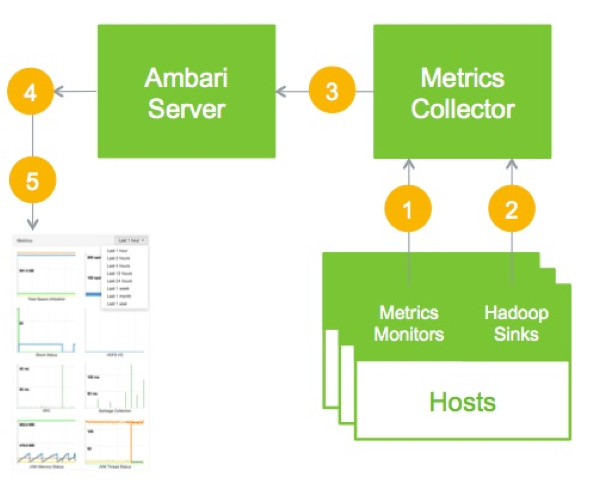

Ambari Metrics System ("AMS") is a system for collecting, aggregating and serving Hadoop and system metrics in Ambari-managed clusters. AMS has three primary components: Metrics Collector, Metrics Monitors and Hadoop Sinks.
  • The Metrics Monitors are installed and run on each host in the cluster to collect system-level metrics and publish to the Metrics Collector.
  • The Hadoop Sinks plug into the various Hadoop components to publish Hadoop metrics to the Metrics Collector.
  • The Metrics Collector is a daemon that runs on a specific host in the cluster and receives data from the registered publishers, the Monitors and Sinks.
The following diagram provides a high-level illustration of how the components of AMS work together to collect metrics and make those metrics available to Ambari.
  1. Metrics Monitors (on each host), send system-level metrics to Collector
  2. Hadoop Sinks (on each host), send system-level metrics to Collector
  3. Metrics Collector stores and aggregates metrics
  4. Ambari exposes REST API for metrics retrieval
  5. Ambari REST API feed Ambari Web UI
