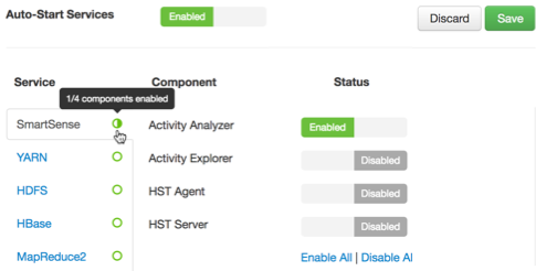

  1. In Auto-Start Services, click a service name.
  2. Click the grey area in the Auto-Start Services control of at least one component, to change its status to Enabled.
    The green icon to the right of the service name indicates the percentage of components with auto-start enabled for the service.
  3. To enable auto-start for all components in the service, click Enable All.
    The green icon fills to indicate all components have auto-start enabled for the service.
  4. To disable auto-start for all components in the service, click Disable All.
    The green icon clears to indicate that all components have auto-start disabled for the service.
  5. To clear all pending status changes before saving them, click Discard.
  6. When you finish changing your auto-start status settings, click Save.

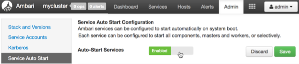

To disable Auto-Start Services:
Steps
  1. In Ambari Web, click Admin > Service Auto-Start.
  2. In Service Auto Start Configuration, click the grey area in the Auto-Start Services control to change its status from Enabled to Disabled.
  3. Click Save.
