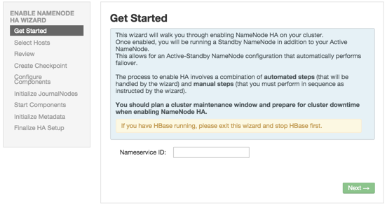

  4. On the Get Started page, type in a Nameservice ID and click Next.
    You use this Nameservice ID instead of the NameNode FQDN after HA is set up.

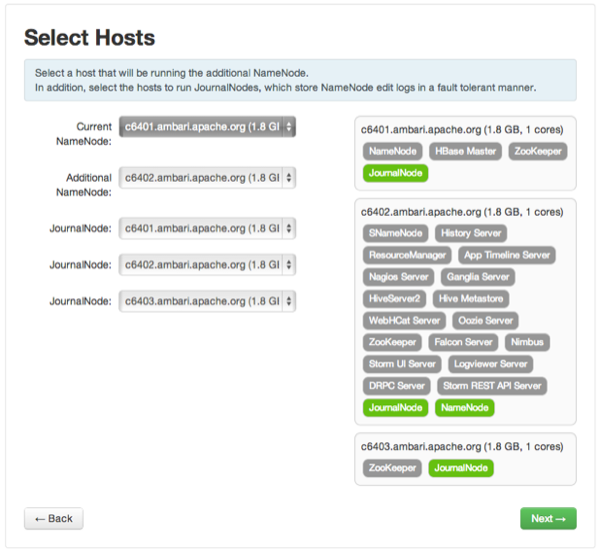

  5. On the Select Hosts page, select a host for the additional NameNode and the JournalNodes, and then click Next:

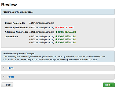

  6. On the Review page, confirm your host selections and click Next:

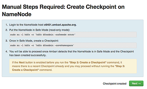

  7. Follow the directions on the Manual Steps Required: Create Checkpoint on NameNode page, and then click Next:
    You must log in to your current NameNode host and run the commands to put your NameNode into safe mode and create a checkpoint.
  8. When Ambari detects success and the message on the bottom of the window changes to Checkpoint created, click Next.

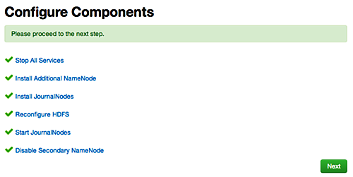

  9. On the Configure Components page, monitor the configuration progress bars, then click Next:

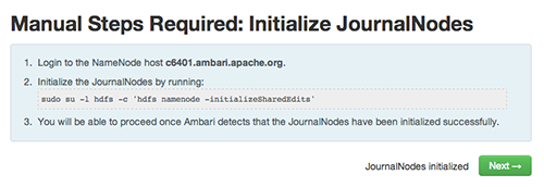

  10. Follow the instructions on the Manual Steps Required: Initialize JournalNodes page and then click Next:
    You must log in to your current NameNode host to run the command to initialize the JournalNodes.
  11. When Ambari detects success and the message on the bottom of the window changes to JournalNodes initialized, click Next.

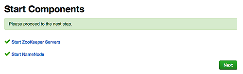

  12. On the Start Components page, monitor the progress bars as the ZooKeeper servers and NameNode start; then click Next:
    [Note]Note
    In a cluster with Ranger enabled, and with Hive configured to use MySQL, Ranger will fail to start if MySQL is stopped. To work around this issue, start the Hive MySQL database and then retry starting components.

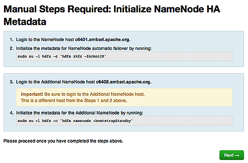

  13. On the Manual Steps Required: Initialize NameNode HA Metadata page : Complete each step, using the instructions on the page, and then click Next.
    For this step, you must log in to both the current NameNode and the additional NameNode. Make sure you are logged in to the correct host for each command. Click OK to confirm, after you complete each command.

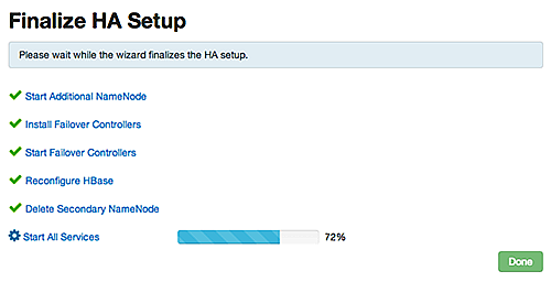

  14. On the Finalize HA Setup page, monitor the progress bars as the wizard completes HA setup, then click Done to finish the wizard.
    After the Ambari Web UI reloads, you may see some alert notifications. Wait a few minutes until all the services restart.
