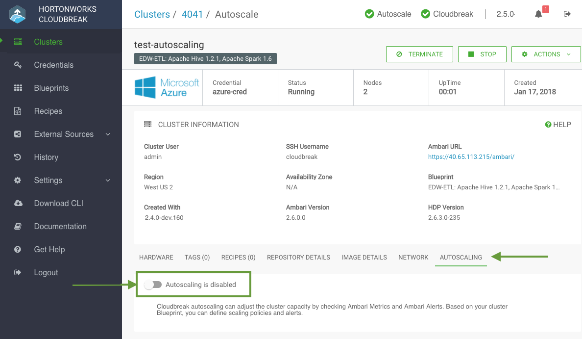

Enable Auto Scaling
For each newly created cluster, autoscaling is disabled by default but it can be enabled once the cluster is in a running state.
Autoscaling configuration is only available in the UI. It is currently not available in the CLI.
Steps
- On the cluster details page, navigate to the Autoscaling tab.
Click the toggle button to enable autoscaling:
The toggle button turns green and you can see that "Autoscaling is enabled".
- Define alerts and then define scaling policies. You can also adjust the autoscaling settings.
If you decide to disable autoscaling, your previously defined alerts and policies will be preserved.
