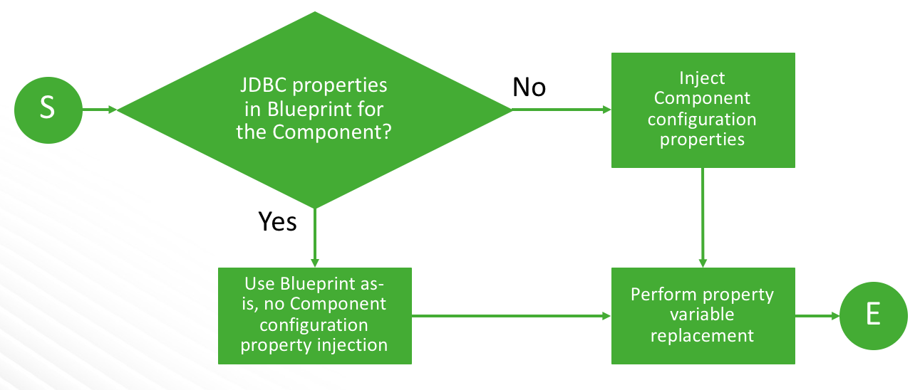

During cluster create, Cloudbreak checks whether the JDBC properties are present in the blueprint:

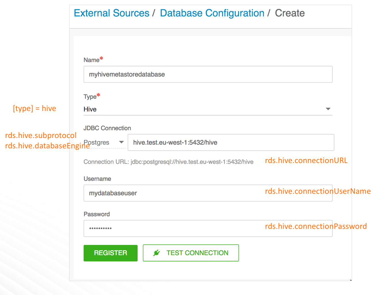

Register an existing external database of "Hive" type (built-in type):
Property Variable Example Value rds.hive.connectionURL jdbc:postgresql://hive.test.eu-west-1:5432/hive rds.hive.connectionDriver org.postgresql.Driver rds.hive.connectionUserName mydatabaseuser rds.hive.connectionPassword Hadoop123! rds.hive.subprotocol postgres rds.hive.databaseEngine POSTGRES -
Create a cluster by using a standard blueprint (i.e. one without JDBC related variables) and by attaching the external Hive database configuration.
Upon cluster create, Hive JDBC properties will be injected into the blueprint according to the following template:
... "hive-site": { "properties": { "javax.jdo.option.ConnectionURL": "{{{ rds.hive.connectionURL }}}", "javax.jdo.option.ConnectionDriverName": "{{{ rds.hive.connectionDriver }}}", "javax.jdo.option.ConnectionUserName": "{{{ rds.hive.connectionUserName }}}", "javax.jdo.option.ConnectionPassword": "{{{ rds.hive.connectionPassword }}}" } }, "hive-env" : { "properties" : { "hive_database" : "Existing {{{ rds.hive.subprotocol }}} Database", "hive_database_type" : "{{{ rds.hive.databaseEngine }}}" } } ...

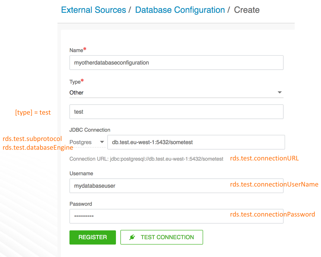

Example 2: Other Type
In this scenario, you start up with a special blueprint including JDBC property variables, and Cloudbreak replaces JDBC-related property variables in the blueprint.
Prepare a blueprint blueprint that includes property variables. Use mustache template syntax. For example:
... "test-site": { "properties": { "javax.jdo.option.ConnectionURL":"{{{rds.test.connectionURL}}}" } ... -
Register an existing external database of some "Other" type. For example:
Property Variable Example Value rds.hive.connectionURL db.test.eu-west-1:5432/sometest rds.hive.connectionDriver org.postgresql.Driver rds.hive.connectionUserName mydatabaseuser rds.hive.connectionPassword Hadoop123! rds.hive.subprotocol postgres rds.hive.databaseEngine POSTGRES -
Create a cluster by using your custom blueprint and by attaching the external database configuration.
Upon cluster create, Cloudbreak replaces JDBC-related property variables in the blueprint.
