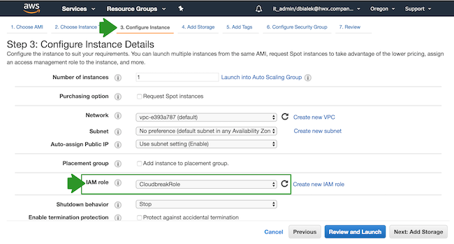

Attach CloudbreakRole when launching the VM
The option to attach an IAM role is available from the instance launch wizard Step 3: Configure Instance:

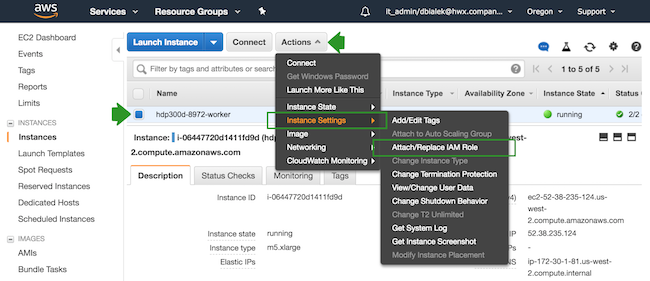

Attach CloudbreakRole to an existing VM
Perform the following steps from the EC2 console on AWS:
- Select the EC2 instance that you are planning to use for Cloudbreak and from the
Actions menu select Instance Settings > Attach/Replace IAM Role:

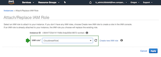

- Next, under IAM role, select the CloudbreakRole that you created earlier and click
Apply to apply the configuration:
