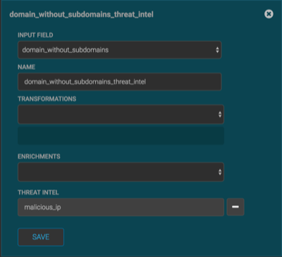

    Figure 5.1. New Schema Information Panel
  5. In the dialog box, enter the name of the new field in the NAME field, choose an input field from the INPUT FIELD box, and choose your transformation from the TRANSFORMATIONS field or enrichment from the ENRICHMENTS field.

      Your new schema information panel should look like this:
    Figure 5.2. Populated New Schema Information Panel
  6. Click SAVE to save your changes.
