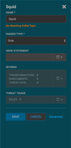

  1. In the Management module, click (edit button) for your sensor.
    The Management module displays the schema panel.
    Figure 3.1. Squid Schema Panel

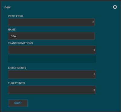

  3. To add a new transformation, either click the next to a field or click the (plus sign) at the bottom of the Schema panel.
    The module displays a new dialog box for your transformations.
    Figure 3.2. New Schema Information Panel

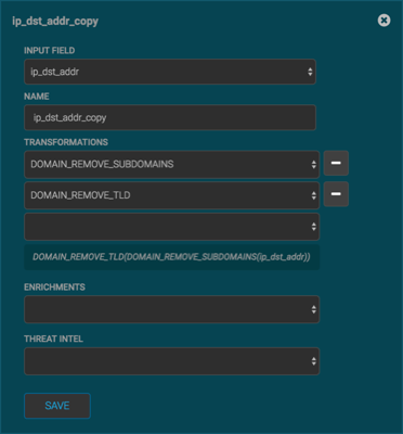

  4. Choose the field you want to transform from the INPUT FIELD box, enter the name of the new field in the NAME field, and then choose a function with the appropriate parameters in the TRANSFORMATIONS box. You can apply more than transformation to the input field.
    Figure 3.3. Populated Schema Information Panel
  5. Click SAVE to save your additions.
    The Management module populates the Transforms field with the number of transformations applied to the sensor.
