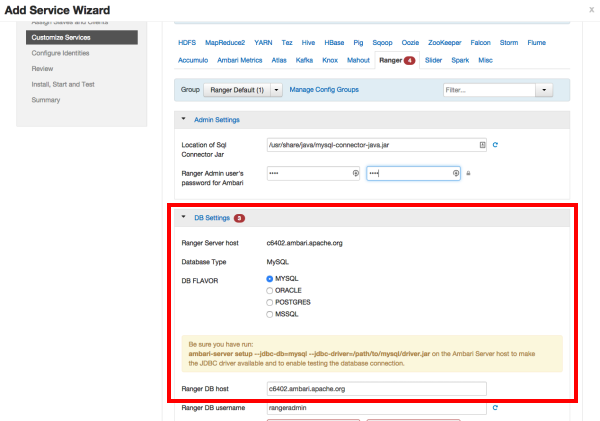

Ranger Ambari Installation
Also available as:
PDF
​DB Settings
  1. Under DB Settings on the Customize Services page, select the "DB Flavor" (installed database type) that you are using with Ranger. The "Location of SQL Connector Jar" box contains the path to the JDBC driver .jar file.
    A message box reminds you to make sure you have set the jdbc/driver/path based on the location of the JDBC driver .jar file for the installed Ranger database. If you have not already done so, set the JDBC driver path as described in the installation prerequisites.

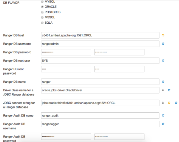

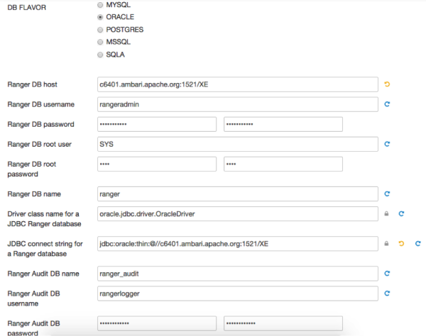

    For Oracle 11g Release 2 and Oracle 12c, the following format must be used for the Ranger DB host and the JDBC connect string:
    • Ranger DB host
      Format:
      • If using a SID: //hostname:port:SID
        Example:
        c6401.ambari.apache.org:1521:ORCL
      • If using a service: //hostname:port/SID
        Example:
        c6401.ambari.apache.org:1521/ORCL
    • JDBC connect string
      • If using a SID: jdbc:oracle:thin@hostname:port:SID
        Example:
        jdbc:oracle:thin:@c6401.ambari.apache.org:1521:ORCL
      • If using a service: jdbc:oracle:thin@//hostname:port/Service
        Example:
        jdbc:oracle:thin:@//c6401.ambari.apache.org:1521/XE
      Note that the Ambari UI will generate the string based on the value provided in the Ranger DB host. But currently it is generating the wrong connection string in certain cases (especially for Oracle DB). Hence you may need to replace the JDBC connection string as described above.
      In an Oracle DB environment, if the JDBC connect string has been overridden to complete the ranger installation, the audit JDBC URLs must also be manually updated in order for DB auditing to work properly.

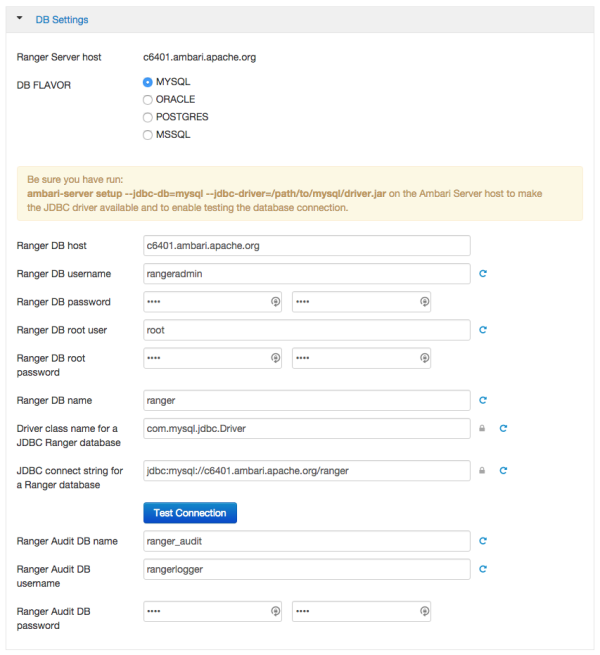

    The following images show examples of the DB Settings for each Ranger database type:
    [Note]Note
    To test the DB settings, click Test Connection. If a Ranger database has not been pre-installed, Test Connection will fail even for a valid configuration.
    MySQL:
    Oracle -- if the Oracle instance is running with a service name:
    [Important]Important
    Note that the Ambari UI will generate the string based on the value provided in the Ranger DB host. But currently it is generating the wrong connection string for Oracle. Therefore you must replace the JDBC connection string as described above.

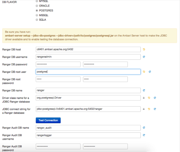

    PostgreSQL:

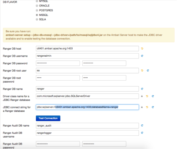

    MS SQL:
