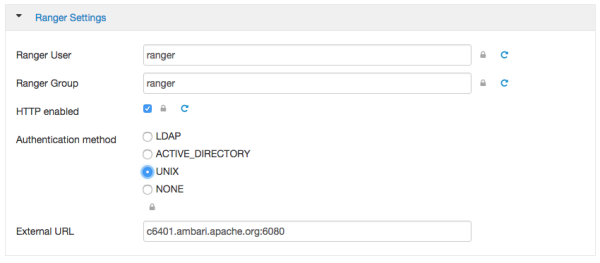

Once you have updated the DB Settings, you will then need to update your existing Ranger settings. The following figure shows the settings, and the table below describes each of these fields.
Table 3.3. Ranger Settings
Configuration PropertyDescriptionDefault ValueExample ValueRequired?
Ranger UserThe value used to create users and assign permissions. This is the OS level user that will be created and used to start the Ranger Admin and Ranger Usersync services.rangerrangerYes
Ranger GroupThe value used to create groups and assign permissions. This is the OS level group that will be created and used to start the Ranger Admin and Ranger Usersync services.rangerrangerYes
HTTP EnabledA check box that specifies whether or not HTTP authentication is enabled. If HTTP is not enabled, only HTTPS is allowed. SelectedSelectedNo
Authentication methodThe type of authentication method used to log into the Policy Manager Only users created within the Policy Manager tool can log in. The available authentication methods are LDAP, Active Directory, UNIX, and NONE. If NONE is selected, Ranger uses the local user database for authentication, and only internal Ranger users can log in. UNIXNoneYes
External URLThe Ranger Policy Manager host. http://<your_ranger_host>:6080Yes
