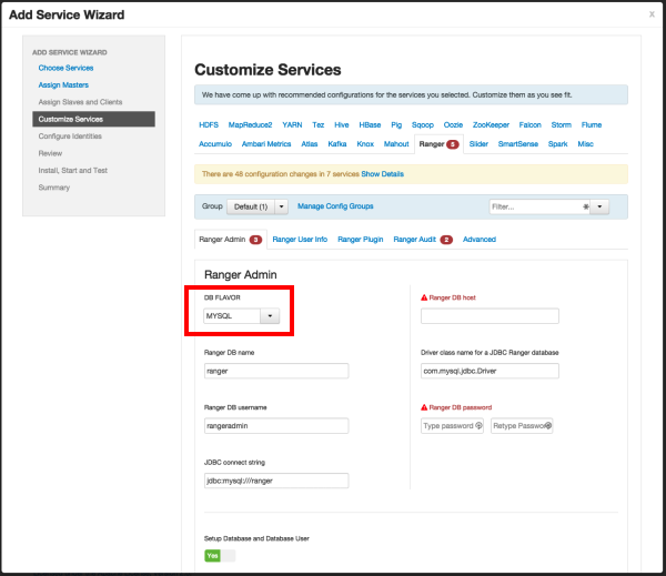

  1. On the Customize Services page, select the Ranger Admin tab, then use the DB Flavor drop-down to select the database type that you are using with Ranger.
  2. Enter the database server address in the Ranger DB Host box.

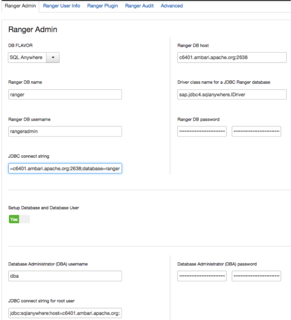

    SQLAjdbc:sqlanywhere:host=DB_HOST;database=db_namejdbc:sqlanywhere:host=c6401.ambari.apache.org:2638;database=ranger_db

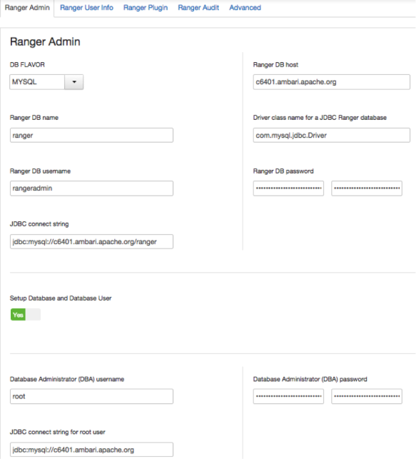

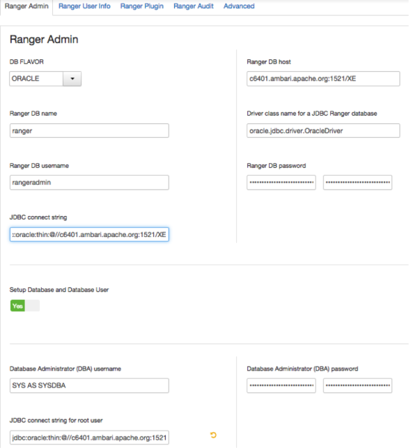

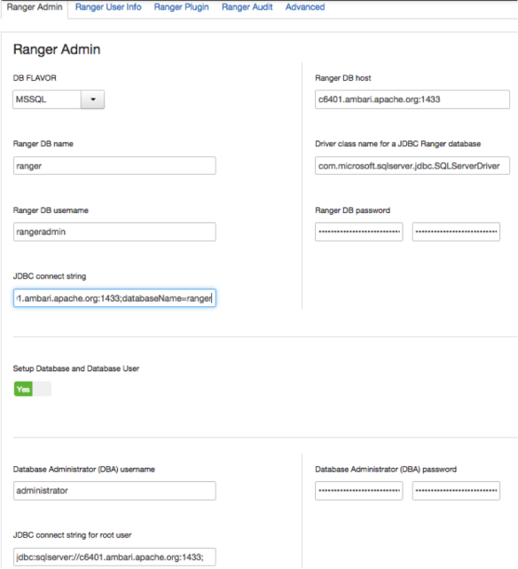

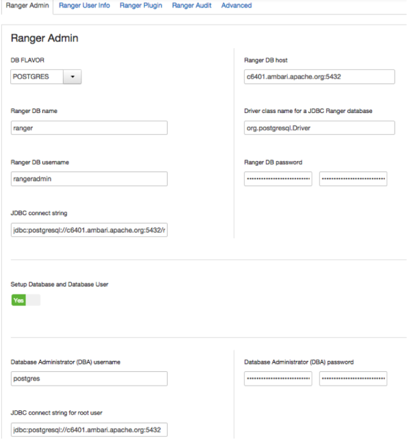

    The following images show examples of the DB settings for each Ranger database type.

    MySQL
    Oracle -- if the Oracle instance is running with a Service name.
    Oracle -- if the Oracle instance is running with a SID.
    PostgreSQL
    MS SQL
    SQL Anywhere
