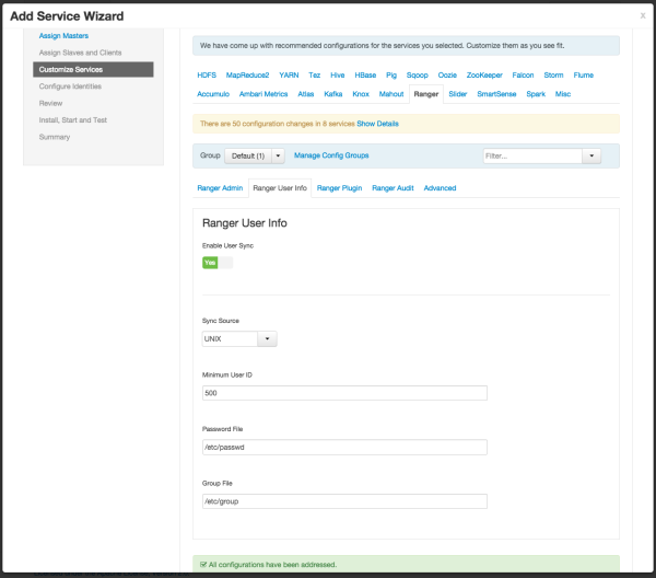

  1. On the Customize Services page, select the Ranger User Info tab.
  2. Click Yes under Enable User Sync.
  3. Use the Sync Source drop-down to select UNIX, then set the following properties.
    Table 3.6. UNIX User Sync Properties
    PropertyDescriptionDefault Value
    Sync SourceOnly sync users above this user ID.500
    Password FileThe location of the password file on the Linux server./etc/passwd
    Group FileThe location of the groups file on the Linux server./etc/group

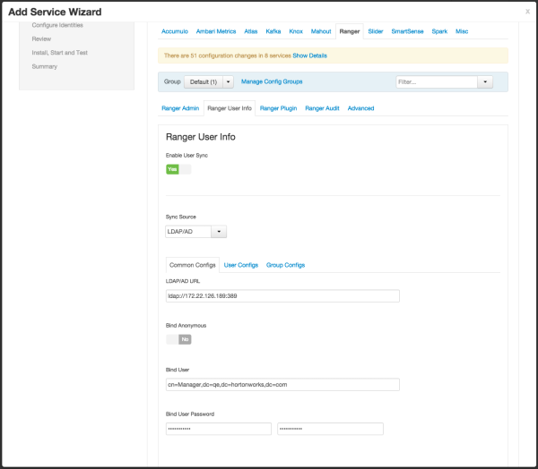

  3. Use the Sync Source drop-down to select LDAP/AD.
  4. Set the following properties on the Common Configs tab.
    Table 3.7. LDAP/AD Common Configs
    PropertyDescriptionDefault ValueSample Values
    LDAP/AD URLAdd URL depending upon LDAP/AD sync sourceldap://{host}:{port}ldap://ldap.example.com:389 or ldaps://ldap.example.com:636
    Bind AnonymousIf Yes is selected, the Bind User and Bind User Password are not required.NO
    Bind UserThe location of the groups file on the Linux server.The full distinguished name (DN), including common name (CN), of an LDAP/AD user account that has privileges to search for users. The LDAP bind DN is used to connect to LDAP and query for users and groups.cn=admin,dc=example,dc=com or admin@example.com
    Bind User PasswordThe password of the Bind User.

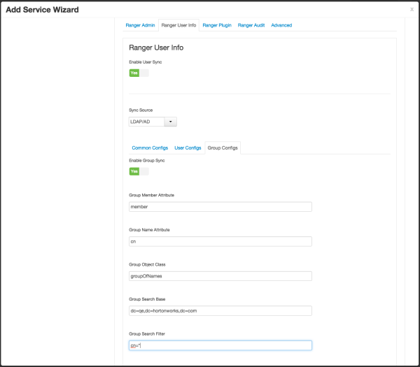

  6. Set the following properties on the Group Configs tab.
    Table 3.9. LDAP/AD Group Configs
    Enable Group Sync
    If Enable Group Sync is set to No, the group names the users belong to are derived from “User Group Name Attribute”. In this case no additional group filters are applied.
    If Enable Group Sync is set to Yes, the groups the users belong to are retrieved from LDAP/AD using the following group-related attributes.
    NoYes
    Group Member AttributeThe LDAP group member attribute name. member
    Group Name AttributeThe LDAP group name attribute. distinguishedName for AD, cn for OpenLdap
    Group Object ClassLDAP Group object class. group, groupofnames, or posixGroup
    Group Search BaseSearch base for groups. ou=groups,DC=example,DC=com
    Group Search FilterOptional additional filter constraining the groups selected for syncing.
    Sample filter to retrieve all groups: cn=*
    Sample filter to retrieve only the groups whose cn is Engineering or Sales: (|(cn=Engineering)(cn=Sales))
