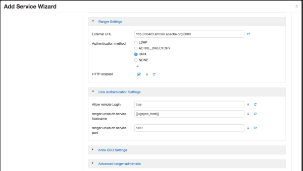

​UNIX Authentication Settings
The following figure shows the UNIX authentication settings, and the table below describes each of these properties.
Table 2.2. UNIX Authentication Settings
Configuration PropertyDescriptionDefault ValueExample ValueRequired?
Allow remote LoginFlag to enable/disable remote login via UNIX Authentication Mode.TRUETRUENo.
ranger.unixauth.service.hostnameThe FQDN where the ranger-usersync module is running (along with the UNIX Authentication Service).localhost
myunixhost.domain.com
Yes, if UNIX authentication is selected.
ranger.unixauth.service.portThe port number where the ranger-usersync module is running the UNIX Authentication Service.51515151Yes, if UNIX authentication is selected.

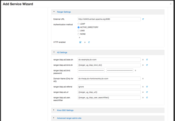

​AD Settings
The following figure shows the Active Directory (AD) authentication settings, and the table below describes each of these properties.
Table 2.3. Active Directory Authentication Settings
Configuration Property NameDescriptionDefault ValueExample ValueRequired?
ranger.ldap.ad.domainServer domain name (or IP address) where ranger-usersync module is running (along with the AD Authentication Service). The default value of "localhost" must be changed to the domain name. localhost
example.com
Yes, if Active Directory authentication is selected.
ranger.ldap.ad.urlThe URL and port number where ranger-usersync module is running the AD Authentication Service. The default value is a placeholder and must be changed to point to the AD server. ldap://ad.xasecure.net:389ldap://127.0.0.1:389Yes, if Active Directory authentication is selected.

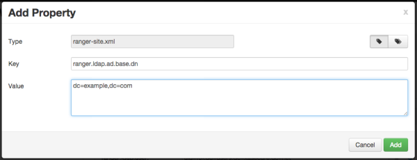

To add a Custom ranger-admin-site property:
  1. Select Custom ranger-admin-site, then click Add Property.
  2. On the Add Property pop-up, type the property name in the Key box, type the property value in the Value box, then click Add.

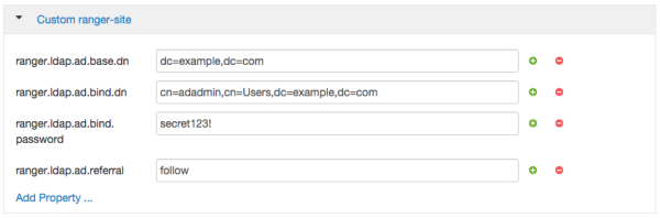

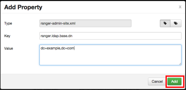

The following figure shows the Custom ranger-admin-site settings required for Active Directory (AD) authentication, and the table below describes each of these properties.
Table 2.4. Active Directory Custom ranger-admin-site Settings
Custom Property NameSample Values for AD Authentication
ranger.ldap.ad.base.dn
dc=example,dc=com
ranger.ldap.ad.bind.dncn=adadmin,cn=Users,dc=example,dc=com
ranger.ldap.ad.bind.passwordsecret123!
ranger.ldap.ad.referralfollow | ignore | throw
There are three possible values for ranger.ldap.ad.referral: follow, throw, and ignore. The recommended setting is follow.
When searching a directory, the server might return several search results, along with a few continuation references that show where to obtain further results. These results and references might be interleaved at the protocol level.
  • When this property is set to follow, the AD service provider processes all of the normal entries first, and then follows the continuation references.
  • When this property is set to throw, all of the normal entries are returned in the enumeration first, before the ReferralException is thrown. By contrast, a "referral" error response is processed immediately when this property is set to follow or throw.
  • When this property is set to ignore, it indicates that the server should return referral entries as ordinary entries (or plain text). This might return partial results for the search. In the case of AD, a PartialResultException is returned when referrals are encountered while search results are processed.
