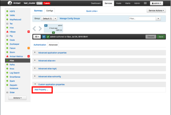

  1. Select Atlas > Configs > Advanced > Custom application-properties, then click Add Property.

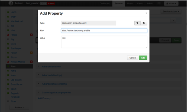

  2. On the Add Property pop-up, add the following properties:
    • Key – atlas.feature.taxonomy.enable
    • Value – true
    Click Add to add the new property.

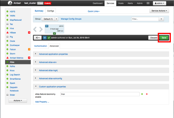

  3. The Advanced tab is redisplayed with the new property. Click Save to save the new configuration.

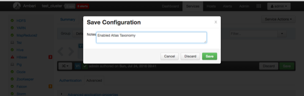

  4. A Save Configuration pop-up appears. Type in a note describing the changes you just made, then click Save.

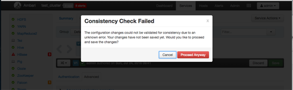

  5. If a Consistency Check Failed pop-up appears, click Proceed Anyway.

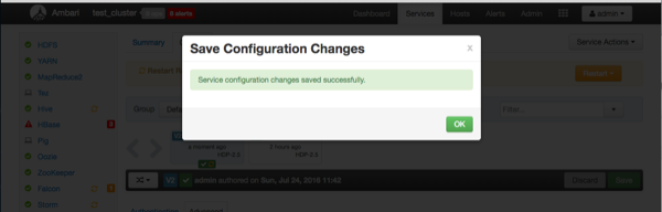

  6. Click OK on the Save Configuration Changes pop-up.

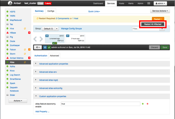

  7. Select Restart > Restart All Affected to restart the Atlas service and load the new configuration.

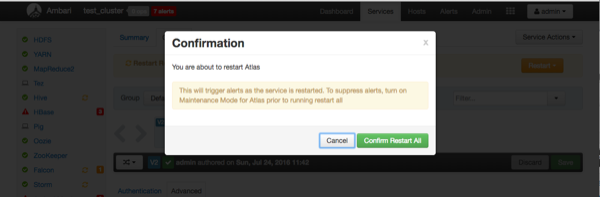

  8. Click Confirm Restart All on the confirmation pop-up to confirm the Atlas restart.

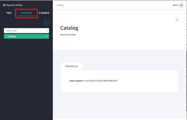

  9. After Atlas restarts, the Taxonomy feature is enabled. Other components may also require a restart. To access the Atlas web UI, select Atlas > Quick Links > Atlas Dashboard.
