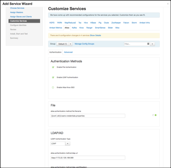

  5. The Customize Services page appears. These settings are described in the next section.
​Customize Services
The next step in the installation process is to specify Atlas settings on the Customize Services page.
​Authentication Settings
You can set the Authentication Type to File, LDAP, or AD.

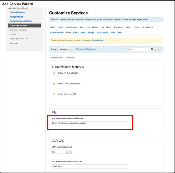

​File-based Authentication
When file-based authentication is selected, the atlas.authentication.method.file.filename property is automtically set to {{conf_dir}}/users-credentials.properties.
The users-credentials.properties file should have the following format:
username=group::sha256password
admin=ADMIN::e7cf3ef4f17c3999a94f2c6f612e8a888e5b1026878e4e19398b23bd38ec221a
The user group can be ADMIN, DATA_STEWARD, or DATA_SCIENTIST.
The password is encoded with the sha256 encoding method and can be generated using the UNIX tool:
echo -n "Password" | sha256sum
e7cf3ef4f17c3999a94f2c6f612e8a888e5b1026878e4e19398b23bd38ec221a -

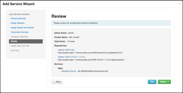

  1. On the Review page, carefully review all of your settings and configurations. If everything looks good, click Deploy to install Atlas on the Ambari server.
    If Kerberos is enabled, you are prompted to enter your KDC administrator credentials. Type in your KDC Admin principal and password, then click Save.
  2. When you click Deploy, Atlas is installed on the specified host on your Ambari server. A progress bar displays the installation progress.
  3. When the installation is complete, a Summary page displays the installation details. Click Complete to finish the installation.
