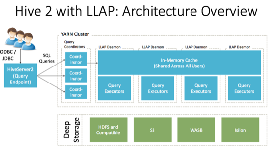

​Hive LLAP Execution Engine
The architecture of Hive LLAP is illustrated in the following diagram.
  • HiveServer2: provides JDBC and ODBC interface, and query compilation
  • Query coordinators: coordinate the execution of a single query LLAP daemon: persistent server, typically one per node. This is the main differentiating component of the architecture, which enables faster query runtimes than earlier execution engines.
  • Query executors: threads running inside the LLAP daemon
  • In-memory cache: cache inside the LLAP daemon that is shared across all users

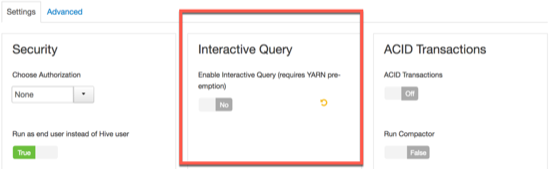

  3. In the Settings tab, locate the Interactive Query section and set the Enable Interactive Query slider to Yes.
    Figure 1.2. Enable Interactive Query Toggle on the Settings Tab

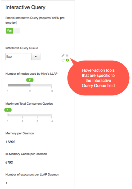

  6. When the Settings subtab opens again, review the additional configuration fields that appear in the Interactive Query section of the window:
    Figure 1.4. Enabled Interactive Query Configuration Settings
    Retain llap as the setting in the Interactive Query Queue drop-down menu. This setting dedicates all the LLAP daemons and all the YARN ApplicationMasters of the system to the single, specified queue.
  7. Set the Number of nodes used by Hive LLAP slider to the number of cluster nodes on which to run Hive LLAP. LLAP automatically deploys to the nodes, and you do not need to label the nodes.
  8. Set the Maximum Total Concurrent Queries slider to the maximum number of concurrent LLAP queries to run. The Ambari wizard calculates and displays a range of values in the slider based on the number of nodes that you selected and the number of CPUs in the Hive LLAP cluster.
  9. Review the following settings, which are autogenerated for informational purposes only. (No interactive elements allow you to directly change the values.)
    Memory per Daemon: YARN container size for each daemon (MB)
    In-Memory Cache per Daemon: Size of the cache in each container (MB)
    Number of executors per LLAP Daemon: The number of executors per daemon: for example, the number of fragments that can execute in parallel on a daemon

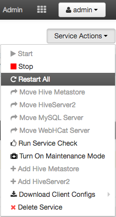

  13. Click Service Actions > Restart All.
    Figure 1.5. Restart All in Top Right Corner of Ambari Window
    Figure 1.6. Enable Interactive Query Toggle on the Settings Tab

    1. Hover over the Interactive Query Queue field to display the hover-action tools, as illustrated in the following screenshot.
    2. Click the Edit (pencil icon) hover action to make the Interactive Query Queue field a drop-down list.
    3. Select the queue for Hive LLAP. This setting dedicates all the LLAP daemons and all the YARN ApplicationMasters of the system to the single, specified queue.
    Figure 1.8. Enabled Interactive Query Configuration Settings

  6. Set the Number of nodes used by Hive LLAP slider to the number of cluster nodes on which to run Hive LLAP. LLAP automatically deploys to the nodes, and you do not need to label the nodes.
  7. Set the Maximum Total Concurrent Queries slider to the maximum number of concurrent Hive LLAP queries to run. The Ambari wizard calculates and displays a range of values in the slider based on the number of nodes that you selected and the number of CPUs in the Hive LLAP cluster. If you want to set the value outside the slider range, move your pointer over the field to enable the hover actions and select the Override tool.
  8. Review the following settings, which are autogenerated for informational purposes only. (No interactive elements allow you to directly change the values.)

  12. Click Service Actions > Restart All.
    Figure 1.9. Restart All in Top Right Corner of Ambari Window

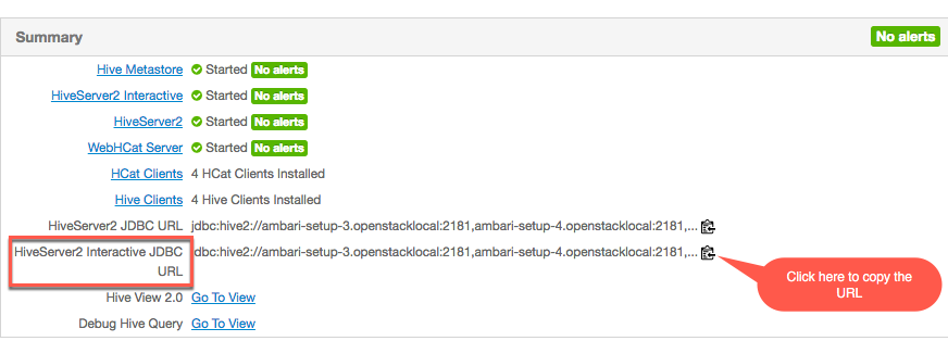

  1. Select the Hive service in the Ambari dashboard.
  2. Click the Summary tab.
  3. Use the clipboard icon to the right of the HiveServer2 Interactive JDBC URL value to copy the URL.
    Figure 1.10. Summary Tab with the HiveServer2 JDBC URLs
  4. Paste the URL into a JDBC client that you use to query the Hive EDW. For example, the client could be a BI tool or Beeline.
