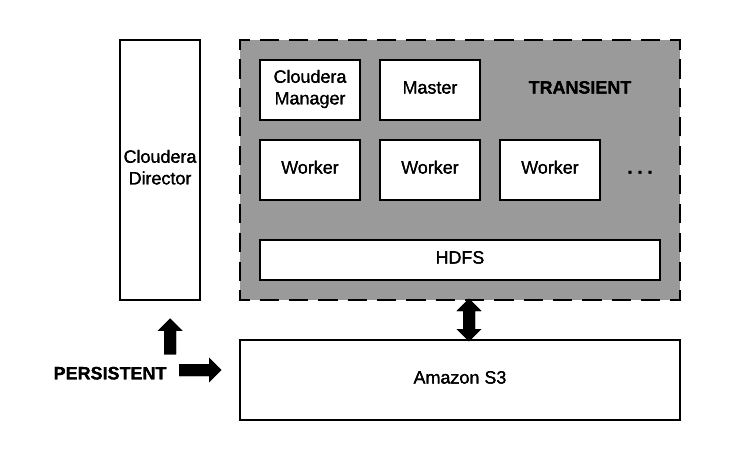

About Transient Jobs
Most ETL jobs on transient clusters run from scripts that make API calls to a provisioning service such as Cloudera Director. They can be triggered by external events, such as IoT (internet of things) events like reaching a temperature threshold, or they can be run on a regular schedule, such as every day at midnight.
Transient Jobs Hosted on Amazon S3
Data residing on Amazon S3 and the node running Cloudera Director are the only persistent components. The computing nodes and local storage come and go with each transient workload.
