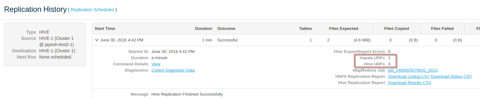

Replication of Impala and Hive User Defined Functions (UDFs)
By default, for clusters where the version of CDH is 5.7 or higher, Impala and Hive UDFs are persisted in the Hive Metastore and are replicated automatically as part of Hive/Impala replications. See Impala User-Defined Functions (UDFs), Replicating Data to Impala Clusters, and Managing Apache Hive User-Defined Functions.
To replicate Impala UDFs when the version of CDH managed by Cloudera Manager is 5.6 or lower, see Replicating Data to Impala Clusters for information on when to select the Replicate Impala Metadata option on the Advanced tab when creating a Hive/Impala replication schedule.
After a replication has run, you can see the number of Impala and Hive UDFs that were replicated during the last run of the schedule on the Replication
Schedules page:
For previously-run replications, the number of replicated UDFs displays on the Replication History page:

Viewing Replication History
You can view historical details about replication jobs on the Replication History page.
To view the history of a replication job:
- Select to go to the Replication Schedules page.
- Locate the row for the job.
- Click .
The Replication History page displays a table of previously run replication jobs with the following columns:

to expand the display and show details of the replication. In this screen, you can:
| Duration | Amount of time the replication job took to complete. |
| Outcome | Indicates success or failure of the replication job. |
| Files Expected | Number of files expected to be copied, based on the parameters of the replication schedule. |
| Files Copied | Number of files actually copied during the replication. |
| Tables | (Hive only) Number of tables replicated. |
| Files Failed | Number of files that failed to be copied during the replication. |
| Files Deleted | Number of files that were deleted during the replication. |
| Files Skipped | Number of files skipped during the replication. The replication process skips files that already exist in the destination and have not changed. |
