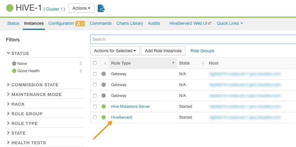

- In Cloudera Manager, from the home page, go to .
- In the Instances page, click the link of the HS2 node that is down:
HiveServer2 Link on the Cloudera Manager Instances Page

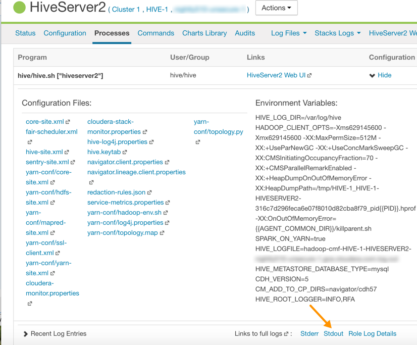

- On the HiveServer2 page, click Processes.
- On the HiveServer2 Processes page, scroll down to the Recent Log Entries and click the link to the Stdout log.
Link to the Stdout Log on the Cloudera Manager Processes Page
- In the stdout.log, look for the following error:
# java.lang.OutOfMemoryError: Java heap space # -XX:OnOutOfMemoryError="/usr/lib64/cmf/service/common/killparent.sh" # Executing /bin/sh -c "/usr/lib64/cmf/service/common/killparent.sh"

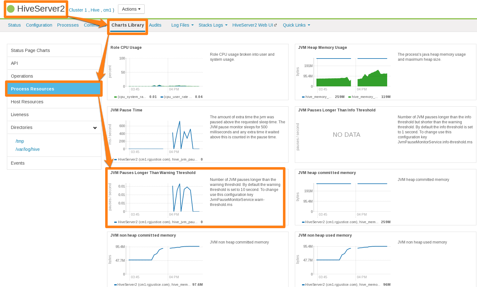

HiveServer2 General Performance Problems or Connections Refused
For general HS2 performance problems or if the service refuses connections, but does not completely hang, inspect the Cloudera Manager process charts:
- In Cloudera Manager, navigate to .
- In the Process Resources section of the Charts Library page, view the JVM Pause Time and the JVM Pauses Longer Than Warning Threshold charts for signs that JVM has paused to manage resources. For example:
Cloudera Manager Chart Library Page for Process Resources
