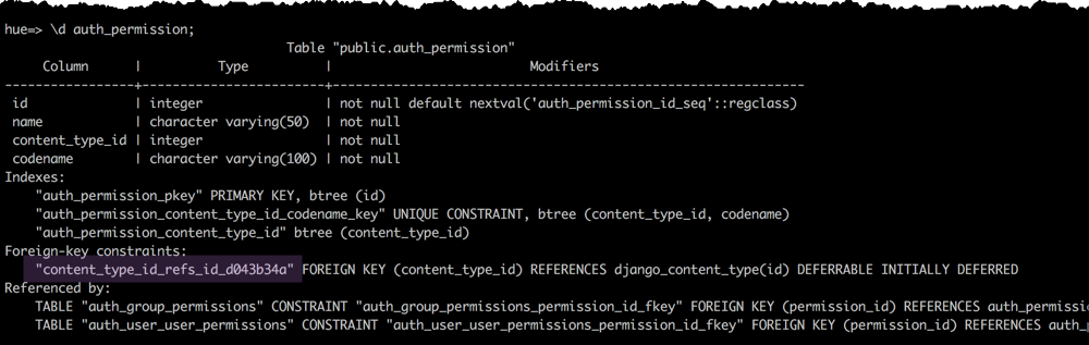

- Drop the foreign key constraint from the auth_permission table in the hue database.
hue=# \d auth_permission; hue=# ALTER TABLE auth_permission DROP CONSTRAINT content_type_id_refs_id_id value;
