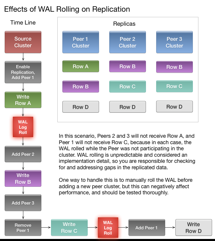

Understanding How WAL Rolling Affects Replication
When you add a new peer cluster, it only receives new writes from the source cluster since the last time the WAL was rolled.
The following diagram shows the consequences of adding and removing peer clusters with unpredictable WAL rolling occurring. Follow the time line and notice which peer clusters receive
which writes. Writes that occurred before the WAL is rolled are not retroactively replicated to new peers that were not participating in the cluster before the WAL was
rolled.

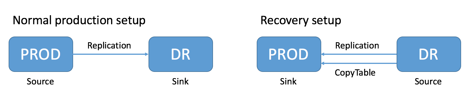

Restoring Data From A Replica
One of the main reasons for replications is to be able to restore data, whether during disaster recovery or for other reasons. During restoration, the source and sink roles are reversed. The source is the replica cluster, and the sink is the cluster that needs restoration. This can be confusing, especially if you are in the middle of a disaster recovery scenario. The following image illustrates the role reversal between normal production and disaster recovery.
- Change the value of the column family property REPLICATION_SCOPE on the sink to 0 for each column to be restored, so that its data will not be replicated during the restore operation.
- Change the value of the column family property REPLICATION_SCOPE on the source to 1 for each column to be restored, so that its data will be replicated.
- Use the CopyTable or distcp commands to import the data from the backup to the sink cluster, as outlined in Initiating Replication When Data Already Exists.
- Add the sink as a replication peer to the source, using the add_peer command as discussed in Deploying HBase Replication. If you used distcp in the previous step, restart or rolling restart both clusters, so that the RegionServers will pick up the new files. If you used CopyTable, you do not need to restart the clusters. New data will be replicated as it is written.
- When restoration is complete, change the REPLICATION_SCOPE values back to their values before initiating the restoration.
