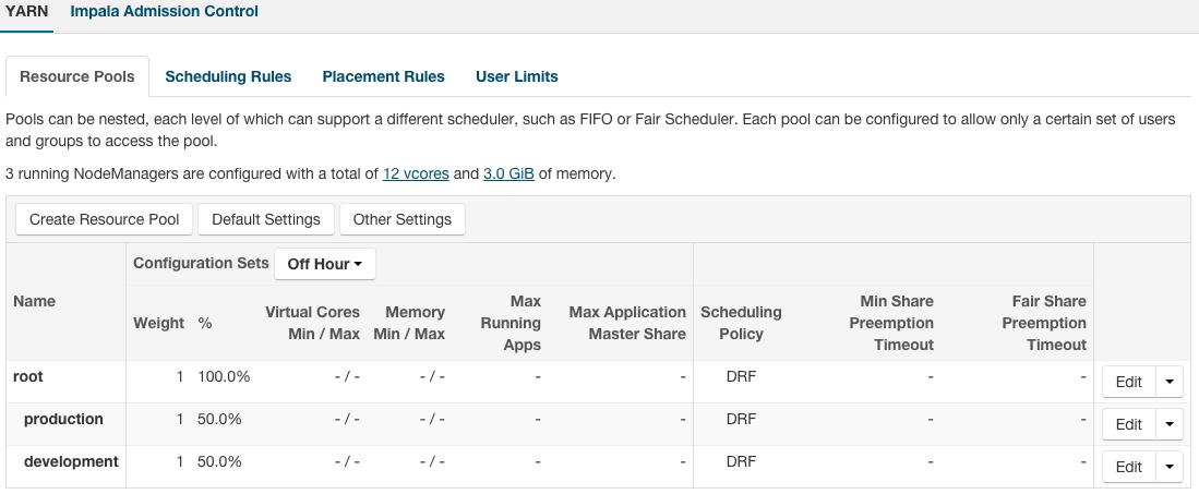

Viewing Dynamic Resource Pool Configuration
- YARN - Weight, Virtual Cores, Min and Max Memory, Max Running Apps, and Scheduling Policy
- Impala Admission Control - Max Memory, Max Running Queries, Max Queued Queries, Queue Timeout, and Default Query Memory Limit
- Select . If the cluster has a YARN service, the tab displays. If the cluster has an Impala service enabled for dynamic resource pools, the tab displays.
- Click the YARN or Impala Admission Control tab.
Creating a YARN Dynamic Resource Pool
- Click the YARN tab.
- Click Create Resource Pool. The Create Resource Pool dialog box displays showing the Configuration Sets tab.
- Specify a name and resource limits for the pool:
- In the Resource Pool Name field, specify the pool name. Enter a unique name containing only alphanumeric characters. If referencing a user or group name that contains a ".", replace the "." with "_dot_".
- Choose a configuration set. Specify a weight that indicates that pool's share of resources relative to other pools, minimum and maximums for virtual cores and memory, and a limit on the number of applications that can run simultaneously in the pool.
- Click the Scheduling Policy tab and select a policy:
- Dominant Resource Fairness (DRF) (default) - An extension of fair scheduling for more than one resource. DRF determines CPU and memory resource shares based on the availability of those resources and the needs of the job.
- Fair (FAIR) - Determines resource shares based on memory.
- First-In, First-Out (FIFO) - Determines resource shares based on when a job was added.
- If you have enabled Fair Scheduler preemption, click the Preemption tab and optionally set a preemption timeout to specify how long a job in this pool must wait before it can preempt resources from jobs in other pools. To enable preemption, follow the procedure in Enabling and Disabling Fair Scheduler Preemption.
- If you have enabled ACLs and specified users or groups, optionally click the Submission and Administration Access Control tabs to specify which users and groups can submit applications and which users can view all and kill applications. By default, anyone can submit, view all, and kill applications. To restrict either of these permissions, select Allow these users and groups and provide a comma-delimited list of users and groups in the Users and Groups fields respectively.
- Click Create.
- Click Refresh Dynamic Resource Pools.

Editing Dynamic Resource Pools
- Click Edit at the right of a resource pool row. Edit the properties.
- Click Save.

Adding Subpools
Pools can be nested as subpools. They share among their siblings the resources of the parent pool. Each subpool can have its own resource restrictions; if those restrictions fall within the configuration of the parent pool, the limits for the subpool take effect. If the limits for the subpool exceed those of the parent, the parent limits take effect.
Once you create subpools, jobs cannot be submitted to the parent pool; they must be submitted to a subpool.
- Select . The tab displays.
- Click
at the right of a resource pool row and select Create
Subpool. Configure subpool properties. - Click Create.

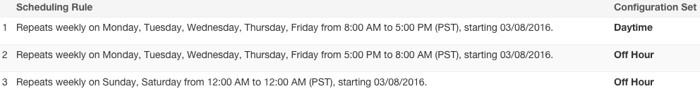

Configuring Configuration Set Schedules
A scheduling rule defines when a configuration set is active. The configurations in the configuration set are propagated to the fair scheduler allocation file as required by the schedule. The updated files are stored in the YARN ResourceManager configuration directory /var/run/cloudera-scm-agent/process/nn-yarn-RESOURCEMANAGER on the host running the ResourceManager role. See Server and Client Configuration.
Example Scheduling Rules
Consider the example Daytime and Off Hour configuration sets. To specify that the Daytime configuration set is active every weekday from 8:00 a.m. to 5:00 p.m. and the Off Hour configuration set is active all other times (evenings and weekends), define the following rules:
Adding a Scheduling Rule
- Click the Scheduling Rules tab.
- Click Create Scheduling Rule.
- In the Configuration Set field, choose the configuration set to which the rule applies. Select the Create New or Use Existing option.
- Do one of the following:
- If you create a new configuration set, type a name in the Name field.
- If you use an existing configuration set, select one from the drop-down list.
- If the rule should repeat, keep the Repeat field selected, and specify the repeat frequency, and if the frequency is weekly, the repeat day or days.
- If the rule should not repeat, deselect the Repeat field, click the left side of the on field to display a drop-down calendar where you set the starting date and time. When you specify the date and time, a default time window of two hours is set in the right side of the on field. Click the right side to adjust the date and time.
- Click Create.
