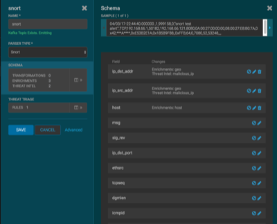

  3. In the Schema box, click (expand window).
    The Management module populates the panel with message, field, and value information.
    The Sample field displays a parsed version of a sample message from the sensor. The Management module tests your transformations against these parsed messages.
    You can use the right and left arrows to view the parsed version of each sample.
    Although you can apply transformations to an existing field, users typically create and transform a new field.
  4. To add a new transformation, either click (edit) next to a field or click (add) at the bottom of the Schema panel.
    pla
  5. From INPUT FIELD, select the field to transform, enter the name of the new field in the NAME field, and then choose a function with the appropriate parameters in the TRANSFORMATIONS box.
  6. Click SAVE.
    If you change your mind and want to remove a transformation, click the "x" next to the field.
  7. You can also suppress fields from the transformation feature by clicking (suppress icon).
    This icon prevents the field from being displayed, but it does not remove the field entirely.
  8. Click SAVE.
