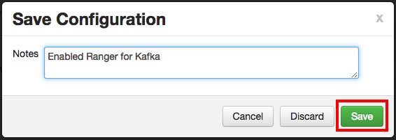

  3. A Save Configuration pop-up appears. Type in a note describing the changes you just made, then click Save.

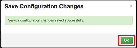

  5. Click OK on the Save Configuration Changes pop-up.
