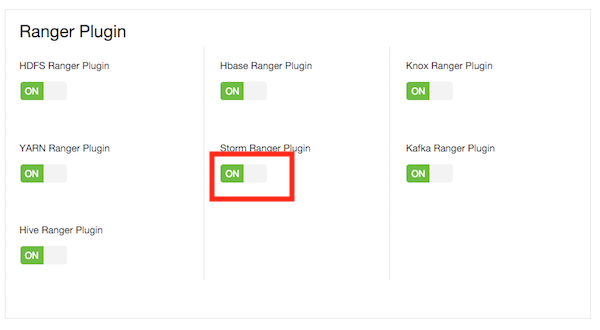

  1. On the Ranger Configs page, select the Ranger Plugin tab.
  2. Under Storm Ranger Plugin, select On, then click Save in the black menu bar.

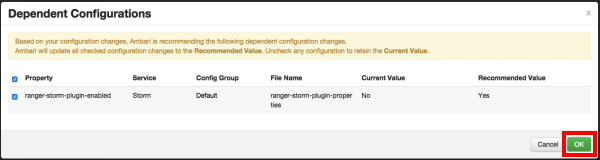

  4. A Dependent Configuration pop-up appears. Click OK to confirm the configuration updates.
