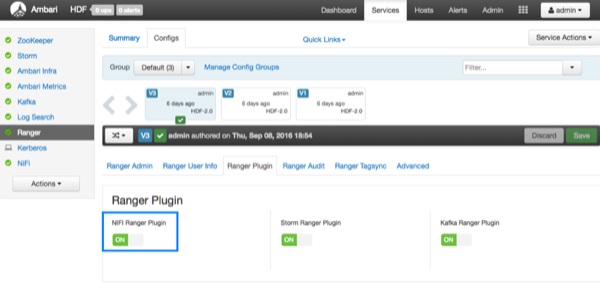

  1. On the Ranger Configs page, select the Ranger Plugin tab.
  2. Under NiFi Ranger Plugin, select ON, then click Save in the black menu bar.
  3. A Save Configuration pop-up appears. Type in a note describing the changes you just made, then click Save.
  4. A Dependent Configuration pop-up appears. Click OK to confirm the configuration updates.
  5. Click OK on the Save Configuration Changes pop-up.

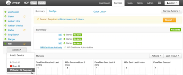

  6. From the left navigation menu click Actions, then Restart All Required to restart NiFi and any additional plugins you have enabled.

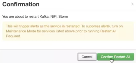

  7. Click Confirm Restart All on the confirmation pop-up to confirm the NiFi restart along with any other servies requiring a restart.
  8. After your services restart, the Ranger plugin is enabled.
