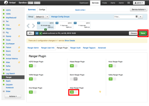

  1. On the Ranger Configs page, select the Ranger Plugin tab.
  2. Under Atlas Ranger Plugin, select On, then click Save in the black menu bar.

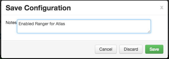

  3. A Save Configuration pop-up appears. Type in a note describing the changes you just made, then click Save.

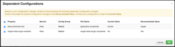

  4. A Dependent Configurations pop-up appears. Click OK to confirm the configuration updates.

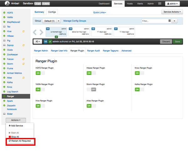

  6. Select Actions in the navigation menu, then select Restart All Required to restart all services that require a restart.

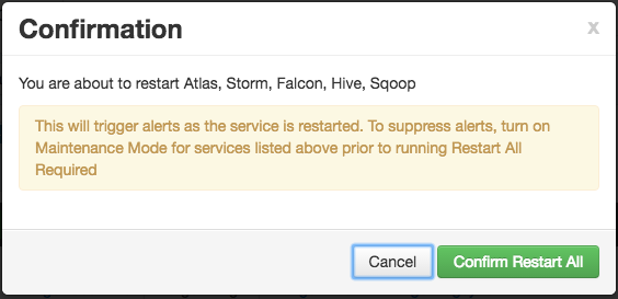

  7. Click Confirm Restart All on the confirmation pop-up to confirm the Storm restart.
  8. After the services restart, the Ranger plugin for Atlas will be enabled.
