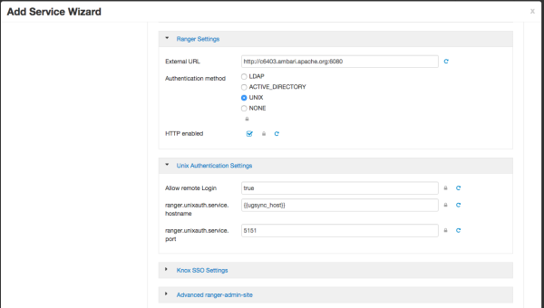

​UNIX Authentication Settings
The following figure shows the UNIX authentication settings, and the table below describes each of these properties.
Table 2.2. UNIX Authentication Settings
Configuration PropertyDescriptionDefault ValueExample ValueRequired?
Allow remote LoginFlag to enable/disable remote login via UNIX Authentication Mode.TRUETRUENo.
ranger.unixauth.service.hostnameThe FQDN where the ranger-usersync module is running (along with the UNIX Authentication Service).localhost
myunixhost.domain.com
Yes, if UNIX authentication is selected.
ranger.unixauth.service.portThe port number where the ranger-usersync module is running the UNIX Authentication Service.51515151Yes, if UNIX authentication is selected.

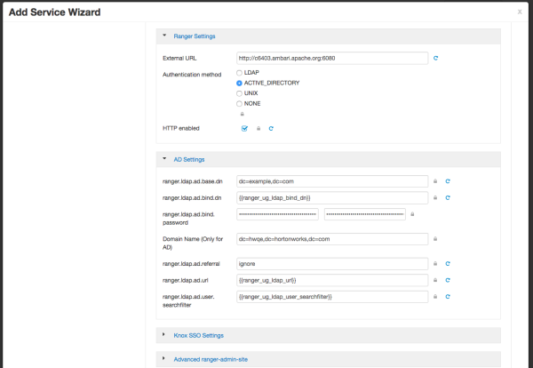

​AD Settings
The following figure shows the Active Directory (AD) authentication settings, and the table below describes each of these properties.
Table 2.3. Active Directory Authentication Settings
Configuration Property NameDescriptionDefault ValueExample ValueRequired?
ranger.ldap.ad.domainServer domain name (or IP address) where ranger-usersync module is running (along with the AD Authentication Service). The default value of "localhost" must be changed to the domain name. localhost
example.com
Yes, if Active Directory authentication is selected.
ranger.ldap.ad.urlThe URL and port number where ranger-usersync module is running the AD Authentication Service. The default value is a placeholder and must be changed to point to the AD server. ldap://ad.xasecure.net:389ldap://127.0.0.1:389Yes, if Active Directory authentication is selected.

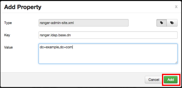

To add a Custom ranger-admin-site property:
  1. Select Custom ranger-admin-site, then click Add Property.
  2. On the Add Property pop-up, type the property name in the Key box, type the property value in the Value box, then click Add.

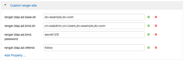

The following figure shows the Custom ranger-admin-site settings required for Active Directory (AD) authentication, and the table below describes each of these properties.
Table 2.4. Active Directory Custom ranger-admin-site Settings
Custom Property NameSample Values for AD Authentication
ranger.ldap.ad.base.dn
dc=example,dc=com
ranger.ldap.ad.bind.dncn=adadmin,cn=Users,dc=example,dc=com
ranger.ldap.ad.bind.passwordsecret123!
ranger.ldap.ad.referralfollow | ignore | throw
There are three possible values for ranger.ldap.ad.referral: follow, throw, and ignore. The recommended setting is follow.

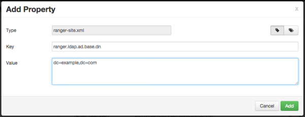

The following figure shows the Custom ranger-admin-site settings required for LDAP authentication, and the table below describes each of these properties.
