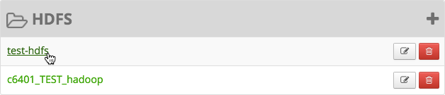

  1. On the Service Manager page, select an existing service under HDFS.
    The List of Policies page appears.

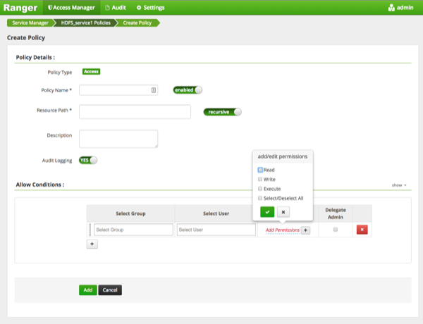

  2. Click Add New Policy.
    The Create Policy page appears.
  3. Complete the Create Policy page as follows:
    Table 3.44. Policy Details
    FieldDescription
    Policy NameEnter a unique name for this policy. The name cannot be duplicated anywhere in the system.
    Resource PathDefine the resource path for the policy folder/file. To avoid the need to supply the full path OR to enable the policy for all subfolders or files, you can either complete this path using wildcards (for example, /home*) or specify that the policy should be recursive. (See below.)
    Description(Optional) Describe the purpose of the policy.
    Audit LoggingSpecify whether this policy is audited. (De-select to disable auditing).
    Table 3.45. Allow Conditions
    Label
    Description
    Select Group
    Specify the group to which this policy applies. To designate the group as an Administrator for the chosen resource, specify Admin permissions. (Administrators can create child policies based on existing policies).
    The public group contains all users, so granting access to the public group grants access to all users.
    Select UserSpecify a particular user to which this policy applies (outside of an already-specified group) OR designate a particular user as Admin for this policy. (Administrators can create child policies based on existing policies).
    PermissionsAdd or edit permissions: Read, Write, Create, Admin, Select/Deselect All.
    Delegate AdminWhen a policy is assigned to a user or a group of users those users become the delegated admin. The delegated admin can update, delete the policies. It can also create child policies based on the original policy (base policy).
    For reference information, see: Wildcard Characters and {USER} Variable.
  4. You can use the Plus (+) symbol to add additional conditions. Conditions are evaluated in the order listed in the policy. The condition at the top of the list is applied first, then the second, then the third, and so on.
  5. Click Add.
