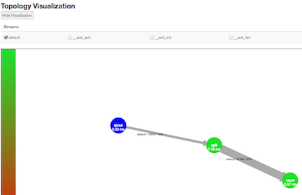

    1. In the Storm UI, click Show Visualization to display a visual representation of your topology and find the data bottleneck in your Storm application.
      • Thicker lines between components denote larger data flows.
      • A blue component represents the the first component in the topology, such as the spout below from the WordCountTopology included with storm-starter.
      • The color of the other topology components indicates whether the component is exceeding cluster capacity: red components denote a data bottleneck and green components indicate components operating within capacity.
