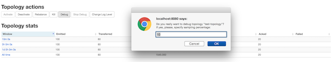

To log events for an entire topology, click the "Debug" button under "Topology actions" in the topology view. This setting logs tuples from all spouts and bolts in a topology at the specified sampling percentage.

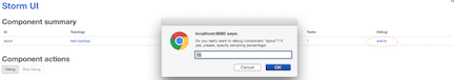

To log events at a specific spout or bolt level, navigate to the corresponding component page and click "Debug" under component actions:

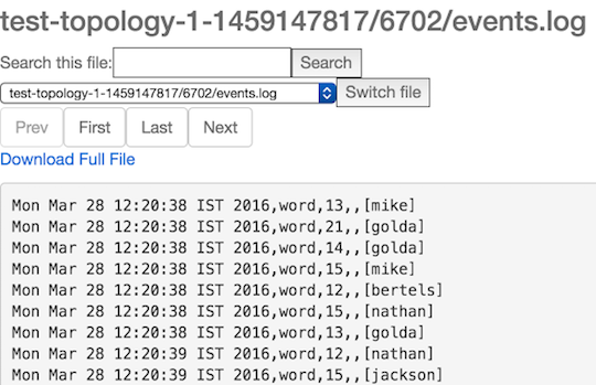

  2. Click on the "events" link in the Debug column of the component summary. This will open a view similar to the following:
    Each line in the event log contains an entry corresponding to a tuple emitted from a specific spout or bolt, presented in a comma-separated format:
    Timestamp, Component name, Component task-id, MessageId (incase of anchoring), List of emitted values
