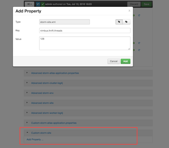

nimbus.thrift.threads
Number of threads to be used by the Nimbus Thrift server. The default is 64 threads. If you have more than ten hosts in your Storm cluster, consider increasing this value to a minimum of 196 threads, to handle the workload associated with multiple workers making multiple requests on each host.
You can set this value by adding the property and its value in the Custom storm-site category, as shown in the following graphic:
