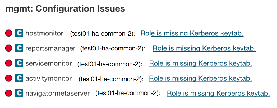

Configuring the Cloudera Management Service for high availability using an existing Cloudera Manager Server cluster (as discussed in Installing the Primary) results in the Cloudera Management Service not starting, as shown here:
This is expected. To resolve, re-generate the Kerberos credentials for the roles:
- Log in to the Cloudera Manager Admin Console.
- Select .
