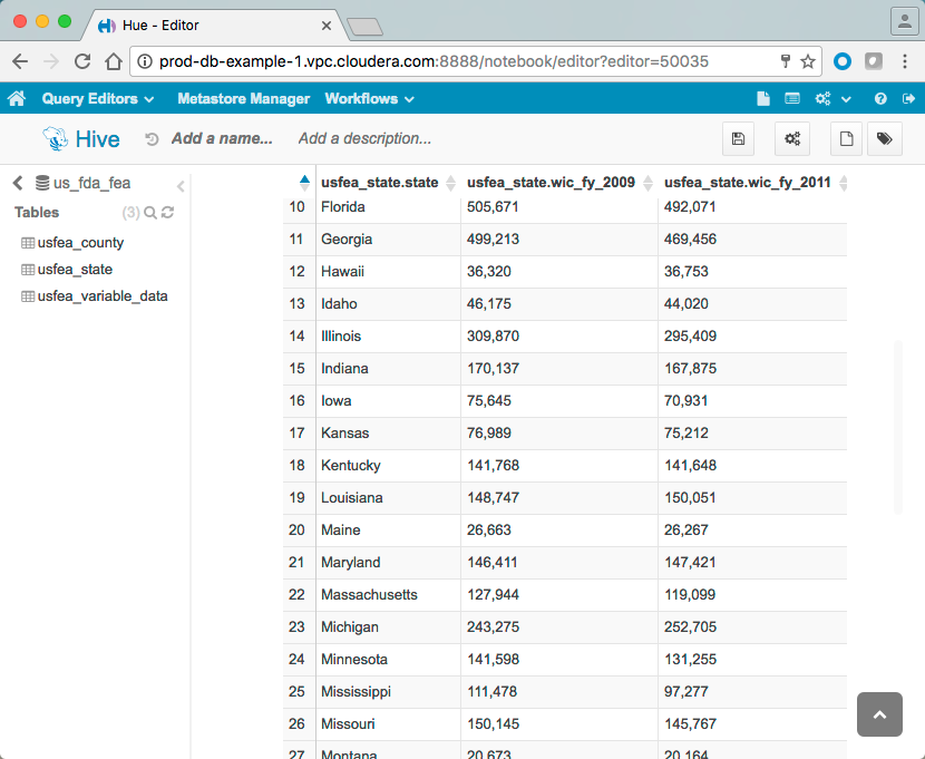

The example production cluster contains the Hive default database and an example database, us_fda_fea, which contains data extracted from the US federal government's open data initiative at data.gov. The us_fda_fea database contains three tables as shown in Hue Web UI:

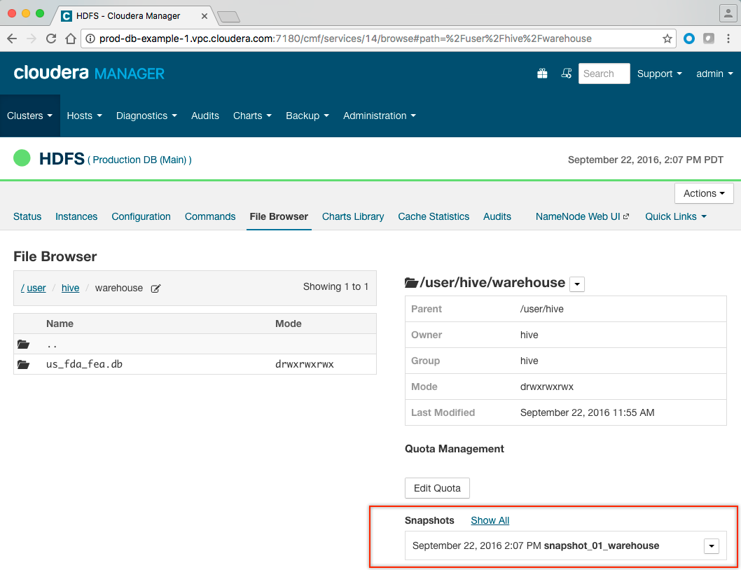

As shown in the screenshot below, snapshots have been configured and enabled on the HDFS system path containing the Hive database files. Using snapshots is one of the Best Practices for Back Up and Restore. See Using Snapshots with Replication for more information.

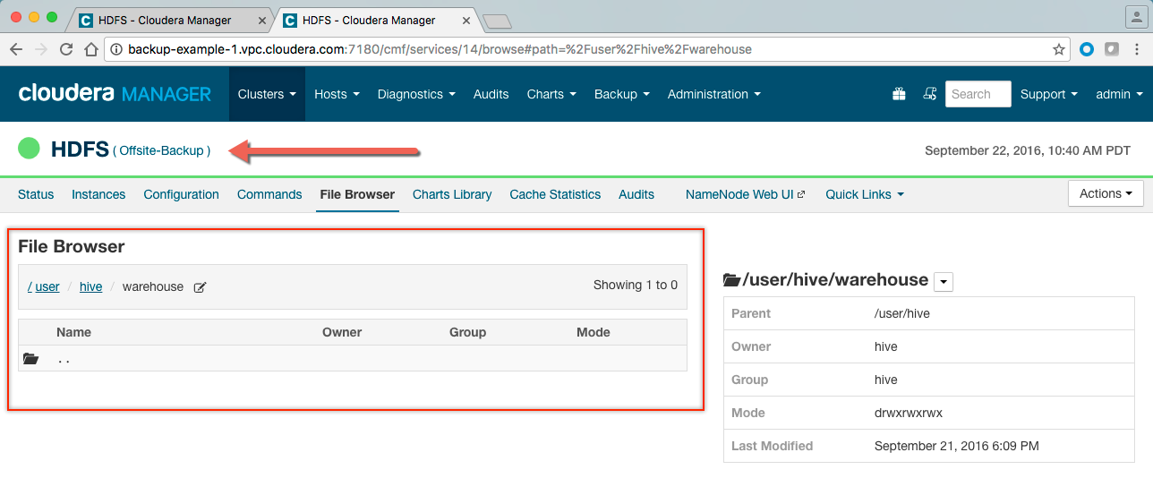

The example backup cluster (Offsite-Backup) has not yet been used for a backup yet, so the Hive default path is empty as shown below:

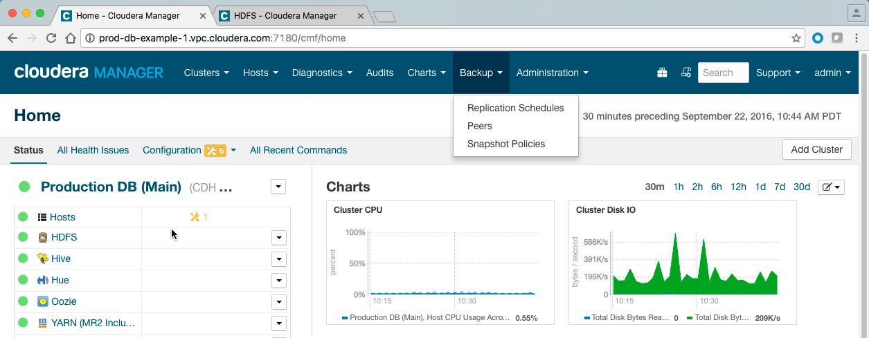

Backup and restore are each configured and managed using Replication Schedules, available from the Backup menu on Cloudera Manager Admin Console:
The backup and restore processes are configured, managed, and executed using replication schedules. Each replication schedule identifies a source and a destination for the given replication process. The replication process uses a pull model. When the replication process runs, the configured destination cluster accesses the given source cluster and transparently performs all tasks needed to recreate the Hive database and tables on the destination cluster.
The destination cluster handles configuration and running the schedule. Typically, creating a backup replication schedule takes place on the backup cluster and creating a restore replication schedule takes place on the production cluster. Thus, as shown in this tutorial, the example production cluster, Production DB (Main), is the source for the backup replication schedule and the destination for the restore replication schedule.

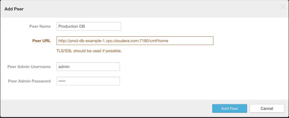

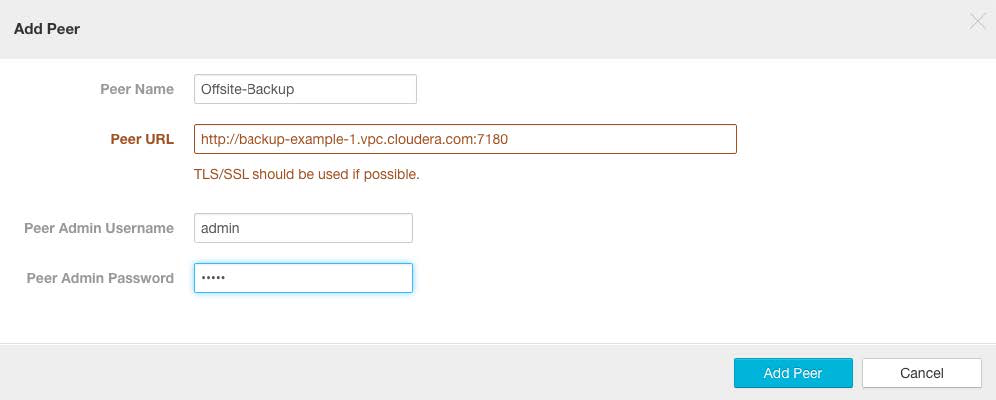

- On the Add Peer page:
- Peer Name - Enter a meaningful name for the cluster that you want to back up, such as Production DB. This peer name becomes available in the next step, to be selected as the source for the replication.
- Peer URL - Enter the URL (including port number) for the Cloudera Manager Admin Console running on the master node of the cluster.
- Peer Admin Username - Enter the name of the administrator account for the cluster.
- Peer Admin Password - Enter the password for the administrator account.

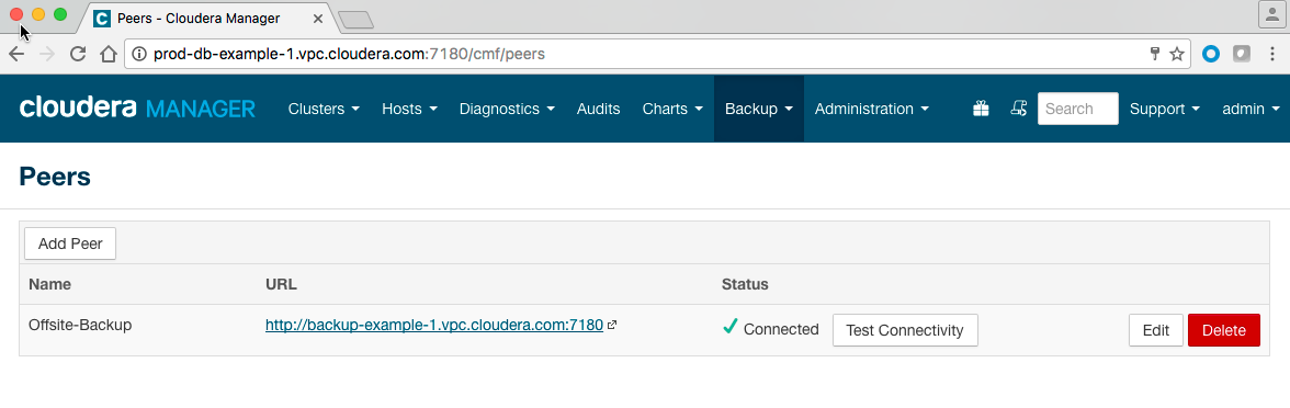

- Click Add Peer to save your settings, connect to the production cluster, and establish this peer relationship.

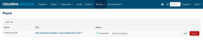

The Peers page re-displays, showing the Status column as Connected (note the green check-mark):
You can now create a schedule to replicate Hive files from production to the backup cluster.

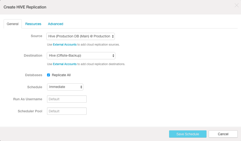

- On the Create Hive Replication page, click the General tab to display the default schedule options:
- Source - Make sure the Hive node selected in the drop-down is the production cluster (the cluster to be backed up).
- Destination - This is the cluster you are logged into, the backup cluster. Select the Hive node on the cluster.
- Databases - Select Replicate All to re-create all Hive databases from the production system to the backup. Or deselect Replicate All and enter specific database name and tables to back up select databases or tables only.
- Schedule - Immediate. For production environments, change this to Recurring and set an appropriate time-frame that can backup the selected dataset completely. For example, do not set an hourly schedule if it takes two hours to back up the dataset.
- Run As Username - Leave as Default.
- Scheduler Pool - Leave as Default.
- Click Save Schedule.
The files are replicated from the source cluster to the backup cluster immediately.
When the process completes, the Replication Schedules page re-displays, showing a green check-mark and time-stamp in the Last Run column:

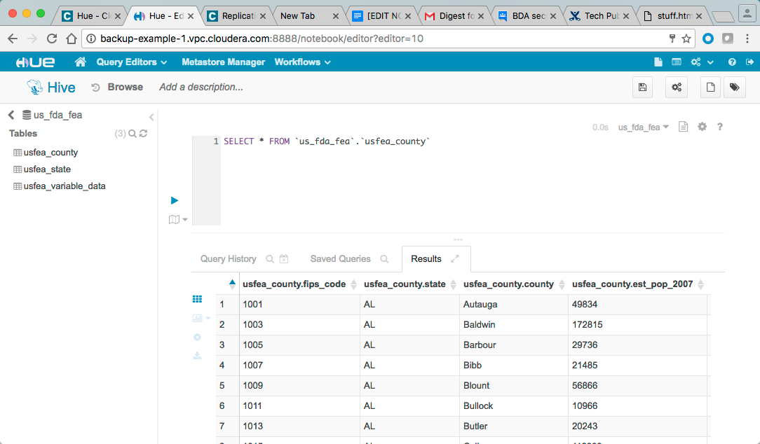

You can verify that data has been replicated by using Hive commands, the HDFS File Browser, or the Hue Web UI (shown below):
The Hive database is now on both the production and the backup clusters—the source and destination of the backup Replication Schedule, respectively.

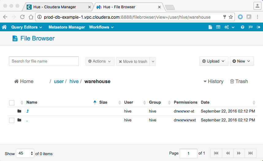

For example, assume that the us_fda_fea database was inadvertently deleted from the example production cluster as shown in the Hue Web UI:

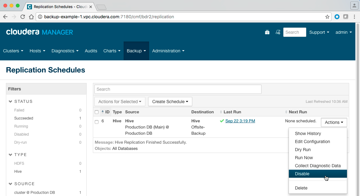

Step 1: Disable Backup Replication Schedule
At the Cloudera Manager Admin Console on the backup cluster:
- Select .
- On the Replication Schedules page, select the schedule.
- From the Actions drop-down menu, select Disable.
When the Replication Schedules pages refreshes, the word Disabled displays in the Next Run column for the schedule.

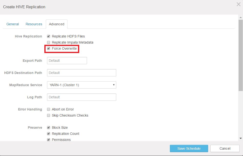

- Click the Advanced tab:
- Select Force Overwrite so that the backup cluster's metadata replaces the metadata on the production cluster. The assumption is that the production cluster's dataset has been corrupted.
