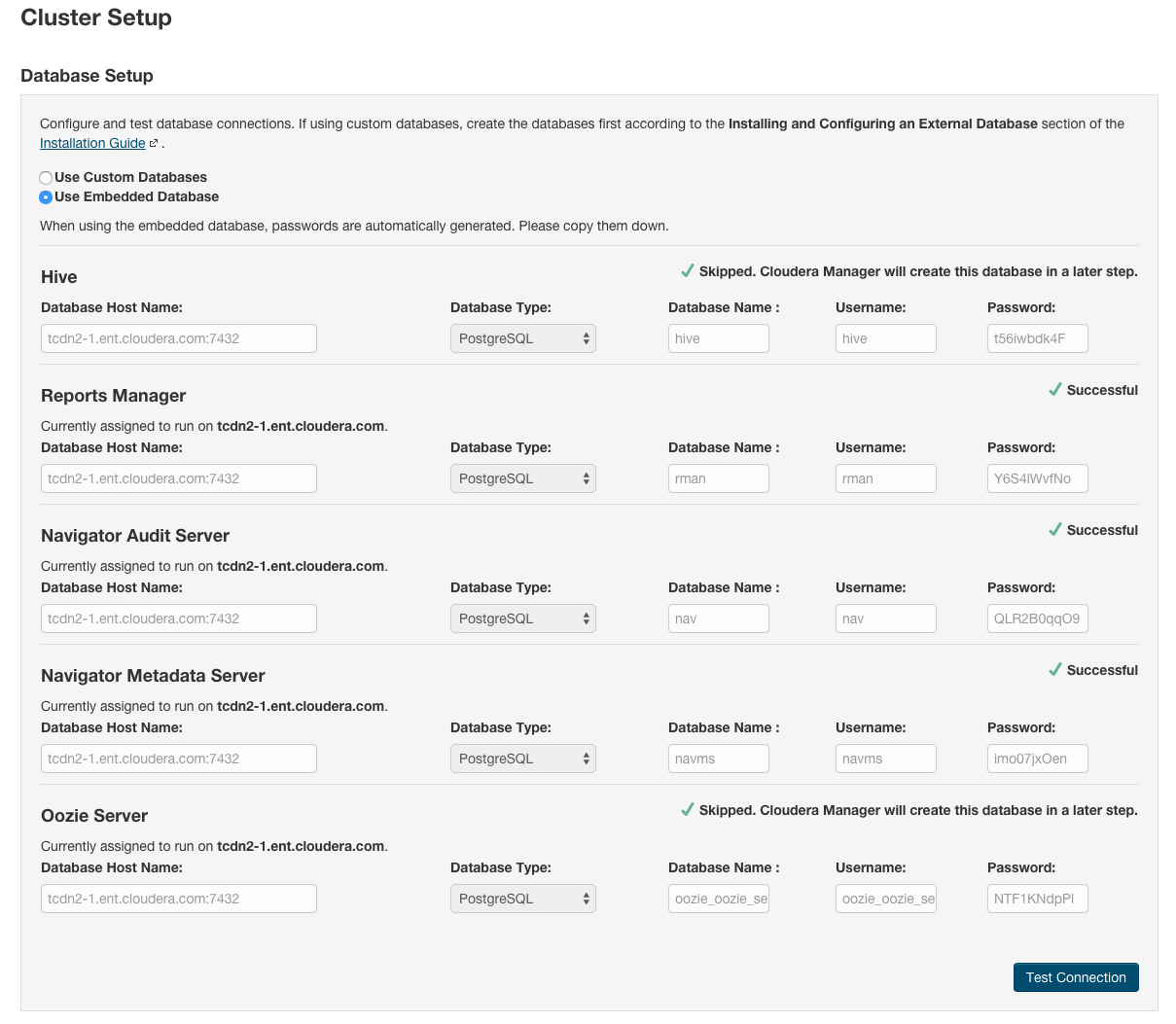

Configure Database Settings
- Choose the database type:
- Keep the default setting of Use Embedded Database to have Cloudera Manager create and configure required databases. Record the auto-generated
passwords.
- Select Use Custom Databases to specify the external database host and enter the database type, database name, username, and password for the custom database.
- If you are adding the Oozie service, you can change your Oozie configuration to control when data is purged to improve performance, reduce database disk usage, improve upgrade performance, or to keep the history for a longer period of time. See Configuring Oozie Data Purge Settings Using Cloudera Manager.
passwords.
- Click Test Connection to confirm that Cloudera Manager can communicate with the database using the information you have
supplied. If the test succeeds in all cases, click Continue; otherwise, check and correct the information you have provided for the database and then try the test
again. (For some servers, if you are using the embedded database, you will see a message saying the database will be created at a later step in the installation process.)
The Cluster Setup Review Changes screen displays.
