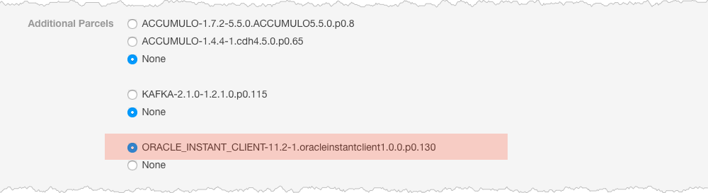

Install CDH and Oracle Parcel
- Open the Cloudera Manager Admin Console and run the Cloudera Manager Installation Wizard to install CDH (and Hue). The URL for Cloudera Manager is: http://<cm server hostname>:7180

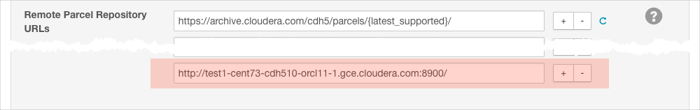

- Stop at Select Repository to add the Oracle client parcel repository (Cluster Installation, step 1):
- Choose Method Use Parcels and click More Options.
- Click
and add the URL for your Oracle Remote
Parcel Repository:
- Click Save Changes.
- Select the newly added radio button by ORACLE_INSTANT_CLIENT and click Continue.

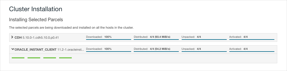

The Oracle parcel is downloaded, distributed, and activated at Cluster Installation, step 6 (Installing Selected Parcels).
