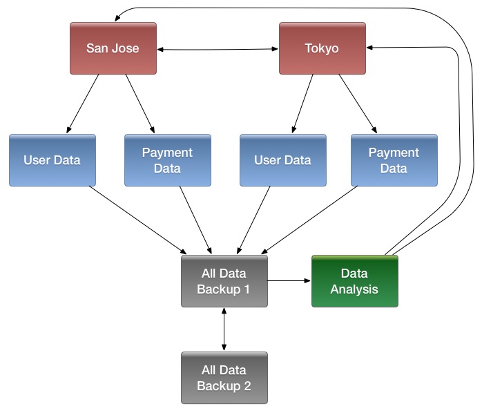

- Multiple levels of replication can be chained together to suit your needs. The following diagram shows a hypothetical scenario. Use the arrows to follow the data paths.
At the top of the diagram, the San Jose and Tokyo clusters, shown in red, replicate changes to each other, and each also replicates changes to a User Data and a Payment Data cluster.
Each cluster in the second row, shown in blue, replicates its changes to the All Data Backup 1 cluster, shown in grey. The All Data Backup 1 cluster replicates changes to the All Data Backup 2 cluster (also shown in grey), as well as the Data Analysis cluster (shown in green). All Data Backup 2 also propagates any of its own changes back to All Data Backup 1.
The Data Analysis cluster runs MapReduce jobs on its data, and then pushes the processed data back to the San Jose and Tokyo clusters.

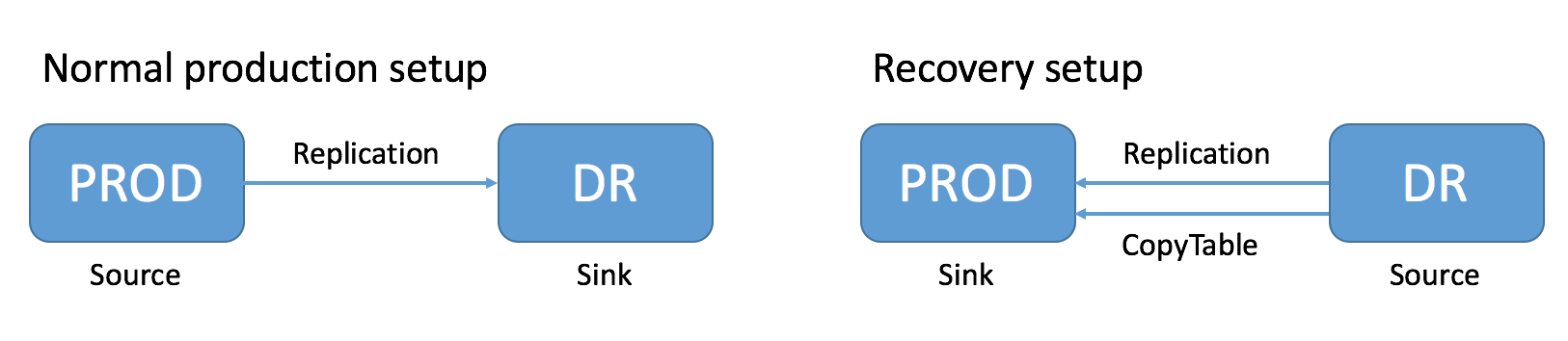

Restoring Data From A Replica
One of the main reasons for replications is to be able to restore data, whether during disaster recovery or for other reasons. During restoration, the source and sink roles are reversed. The source is the replica cluster, and the sink is the cluster that needs restoration. This can be confusing, especially if you are in the middle of a disaster recovery scenario. The following image illustrates the role reversal between normal production and disaster recovery.
- Change the value of the column family property REPLICATION_SCOPE on the sink to 0 for each column to be restored, so that its data will not be replicated during the restore operation.
- Change the value of the column family property REPLICATION_SCOPE on the source to 1 for each column to be restored, so that its data will be replicated.
- Use the CopyTable or distcp commands to import the data from the backup to the sink cluster, as outlined in Initiating Replication When Data Already Exists.
- Add the sink as a replication peer to the source, using the add_peer command as discussed in Deploying HBase Replication. If you used distcp in the previous step, restart or rolling restart both clusters, so that the RegionServers will pick up the new files. If you used CopyTable, you do not need to restart the clusters. New data will be replicated as it is written.
- When restoration is complete, change the REPLICATION_SCOPE values back to their values before initiating the restoration.
