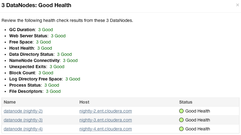

If there are multiple role instances (such as for DataNodes, TaskTrackers, RegionServers) clicking
to the right of the role's health
displays a pop-up that allows you to select specific instances. Furthermore, this pop-up displays the results for each health test that applies to this role type.
You can filter by an individual health test result. Click the result link - an
appears by the link
(as shown in the illustration above) and only the instance(s) with that specific health status will appear in the instances list.

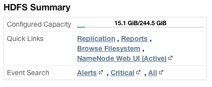

Service Summary
- The HDFS Summary shows disk space usage.
- The MapReduce Summary shows statistics on slot usage, jobs and so on.
- The Flume Summary provides a link to a page of Flume metric details. See Flume Metric Details.
- The ZooKeeper Summary provides links to the ZooKeeper role instances (nodes) as well as Zxid information if you have a ZooKeeper Quorum (multiple ZooKeeper servers).
For example:
Other services such as Hue, Oozie, Impala, and Cloudera Manager itself, do not provide a Service Summary.
