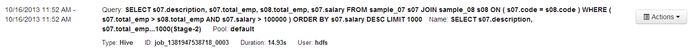

Jobs are ordered with the most recent at the top. Each job has summary and detail information. A job summary includes the following attributes: start and end timestamps, query (if the
job is part of a Hive query) name, queue, job type, job ID, and user. For example:
You can add additional attributes to the summary with the Attribute Selector. To display information about job attributes and possible values, hover over a field in an entry. For example:

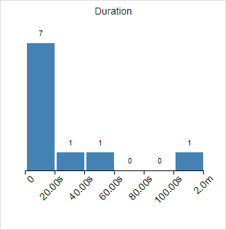

Example: Drilling into Query Results
Suppose we have a set of results with the following duration distribution :

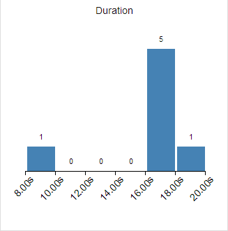

The 0-20.00s bucket has 7 results, but with the current distribution we cannot discriminate between the results in that bucket.
<x>_duration >= 0.0 AND <x>_duration < 20000.0

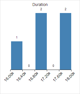

<x>_duration >= 16000.0 AND <x>_duration < 18000.0After clicking Search again, the histogram appears as follows:
