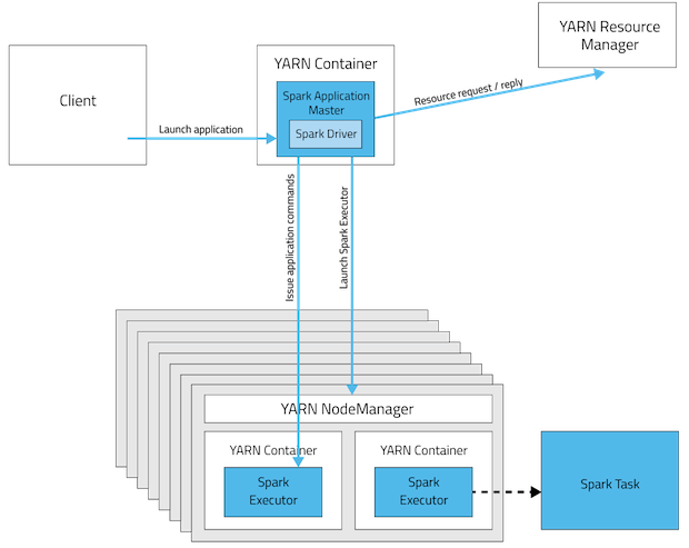

Cluster Deployment Mode
In cluster mode, the Spark driver runs in the ApplicationMaster on a cluster host. A single process in a YARN container is responsible for both driving the application and requesting
resources from YARN. The client that launches the application does not need to run for the lifetime of the application.
Cluster mode is not well suited to using Spark interactively. Spark applications that require user input, such as spark-shell and pyspark, require the Spark driver to run inside the client process that initiates the Spark application.

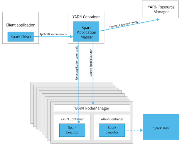

Client Deployment Mode
In client mode, the Spark driver runs on the host where the job is submitted. The ApplicationMaster is responsible only for requesting executor containers from YARN. After the containers
start, the client communicates with the containers to schedule work.
| Mode | YARN Client Mode | YARN Cluster Mode |
| Driver runs in | Client | ApplicationMaster |
| Requests resources | ApplicationMaster | ApplicationMaster |
| Starts executor processes | YARN NodeManager | YARN NodeManager |
| Persistent services | YARN ResourceManager and NodeManagers | YARN ResourceManager and NodeManagers |
| Supports Spark Shell | Yes | No |
