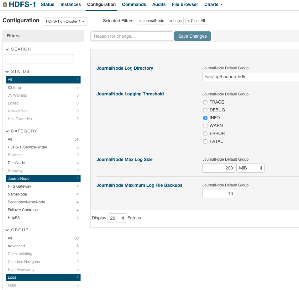

New layout pages contain controls that allow you filter configuration properties based on configuration status, category, and group. For example, to display the JournalNode maximum log size property (JournalNode Max Log Size), click the and filters:
When a configuration property has been set to a value different from the default, a reset to default value icon
displays.

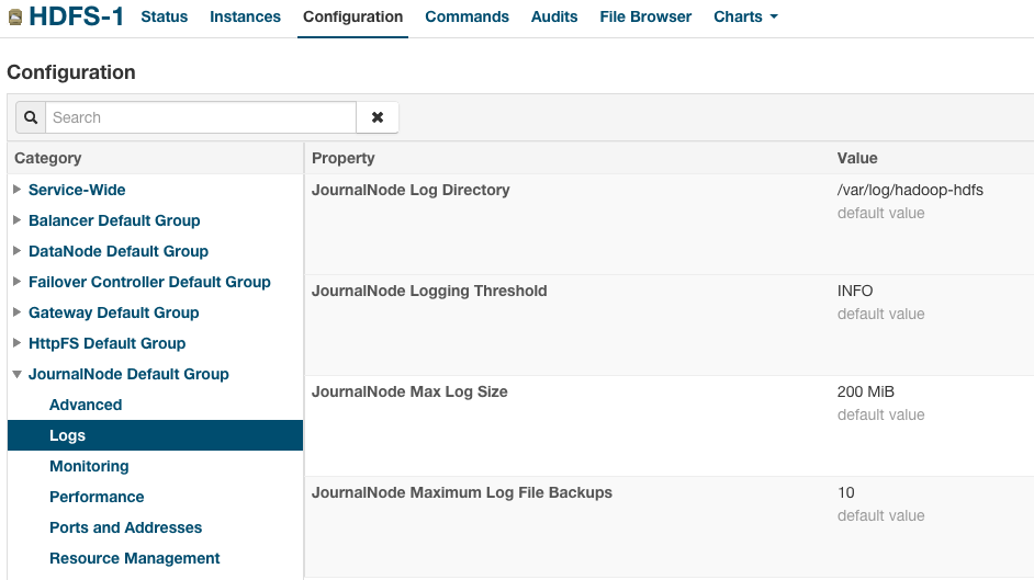

Classic layout pages are organized by role group and categories within the role group. For example, to display the JournalNode maximum log size property (JournalNode Max Log Size), select .
When a configuration property has been set to a value different from the default, a Reset to the default value link displays.
