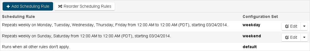

- Define one or more scheduling rules to specify when the configuration set is active.
Example Configuration Sets

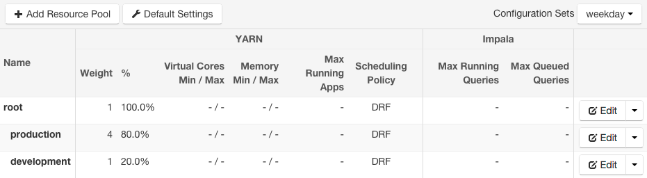

The weekday configuration set assigns the production pool four times the resources of the development pool:

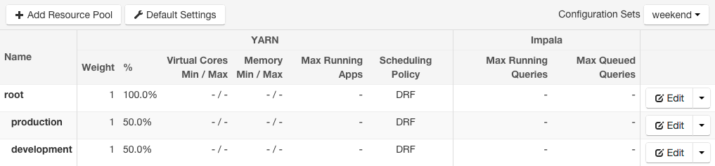

The weekend configuration set assigns the production and development pools an equal share of the resources:

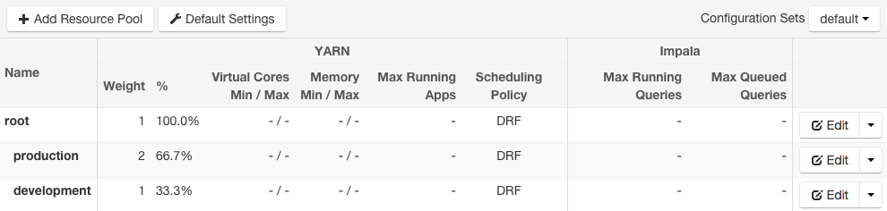

The default configuration set assigns the production pool twice the resources of the development pool:
See example scheduling rules for these configuration sets.

Scheduling Rules
A scheduling rule defines when a configuration set is active. The configuration set is updated in affected services every hour.
Example Scheduling Rules
Consider the example weekday and weekend configuration sets. To specify that the weekday configuration set is active every weekday, weekend configuration set is active on the weekend (weekly on Saturday and Sunday), and the default configuration set is active all other times, define the following rules:
Adding a Scheduling Rule
- Select . If the cluster has a YARN service, the Dynamic Resource Pools Status tab displays. If the cluster has only an Impala service enabled for dynamic resource pools, the Dynamic Resource Pools Configuration tab displays.
- If the Status page is displayed, click the Configuration tab. A list of the currently configured pools with their configured limits displays.
- Click the Scheduling Rules tab.
- Click Add Scheduling Rule.
- In the Configuration Set drop-down, select a configuration set.
- Choose whether the rule should repeat, the repeat frequency, and if the frequency is weekly, the repeat day or days.
- If the schedule is not repeating, click the left side of the on field to display a drop-down calendar where you set the starting date and time. When you specify the date and time, a default time window of two hours is set in the right side of the on field. Click the right side to adjust the date and time.
- Click OK.
