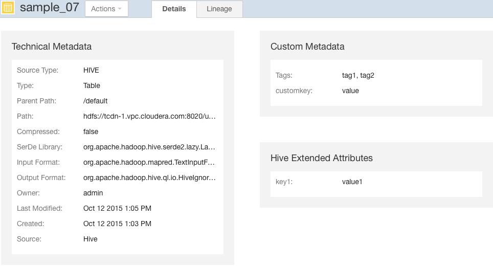

Displaying Entity Details
- Perform a search.
- In the search results, click an entity name link. For example, if you click the Hive table sample_07 link in the search result displayed in the preceding
section, you could see the following details:
In addition to the technical metadata, this Hive table has custom metadata consisting of tags tag1 and tag2 and a key-value pair customkey-value, and an extended attribute key-value pair key1-value1.

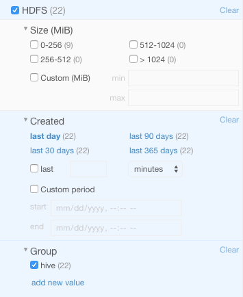

When you select a specific source type value, additional properties that apply to that source type display. For example, HDFS has size, created, and group properties:
The number in parentheses (facet count) after a property value is the number of extracted entities that have that property value:
Facet values with the count of 0 are not displayed.
