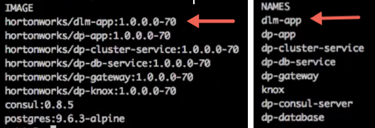

  5. Verify that the container you installed is running.
    docker ps
    The entry should be similar to the following:
    If any containers are not running, you must destroy the containers and start over, as described in the troubleshooting section of this guide.
