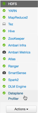

  5. In the Ambari Services navigation pane, click Actions>Add Service.
    The Add Service Wizard displays.
  6. On the Choose Services page of the Wizard, select the DPS service to install in Ambari, and then follow the on-screen instructions.

  11. If you added DataPlane Profiler, complete the following configuration steps.
    1. Return to the Ambari main page.
    2. In the Services pane, click DataPlane Profiler.
    3. Click Configs>Advanced, and then scroll to Custom core-site.
