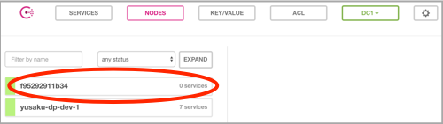

  1. Navigate to the Consul UI.
    http://<dataplane-host>:8500
  2. Click on the Nodes tab.

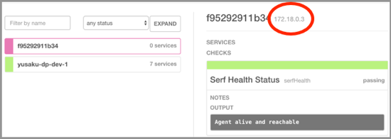

  3. Click the node that is identified with a hexadecimal string and 0 services.
  4. Make note of the IP address from the information panel that appears for the selected node.
    Retain this IP address. You need it to complete the configuration of the packaged LDAP server that you can use for testing purposes.

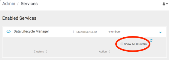

  1. Click the (Services) icon in the DPS Platform navigation pane.
    The Services page displays. Services listed in the table have been enabled. Services identified by a tile icon are available to be enabled.
  2. Click on the row for a service.
    A list displays of any clusters that have the required service engine installed but have not yet been configured for use with the service.
    If no clusters display for the service, verify that the clusters you expect to see have been registered with DPS Platform, and that the proper service engine has been installed on the clusters.
  3. Click Enable for the clusters you want to use with the service.

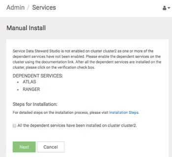

    A check is run to determine what configuration is required on the cluster for the service you selected. For example, a required service such as Apache Ranger might have been installed on the clusters, but has not been enabled in Apache Ambari.
    The Manual Install page displays, indicating what you need to configure on the cluster to make the cluster usable by the service.
    1. Perform the actions stated on the Manual Install page.
      The required actions often involve enabling a service from Ambari. For example:
    2. When you complete the required actions, go to step 4.
  4. On the Manual Install page, select the item "All the dependent services have been installed..." and click Next.
    Another configuration check is run and if all requirements are met, a verification message displays, indicating that the cluster meets requirements for the service.
  5. Click the name of the service for which you enabled the cluster, then enable Show All Clusters.
    The new cluster displays in the list on the Clusters page.
