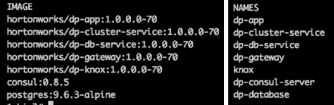

  9. Verify which DPS Platform UI containers are running.
    docker ps
    If using an external database, six containers should be running.
    If using the packaged database, seven containers should be running, similar to what is shown in the following example:
    If all of the containers are not running, you must destroy the containers and start over, as described in the troubleshooting section of this guide.
