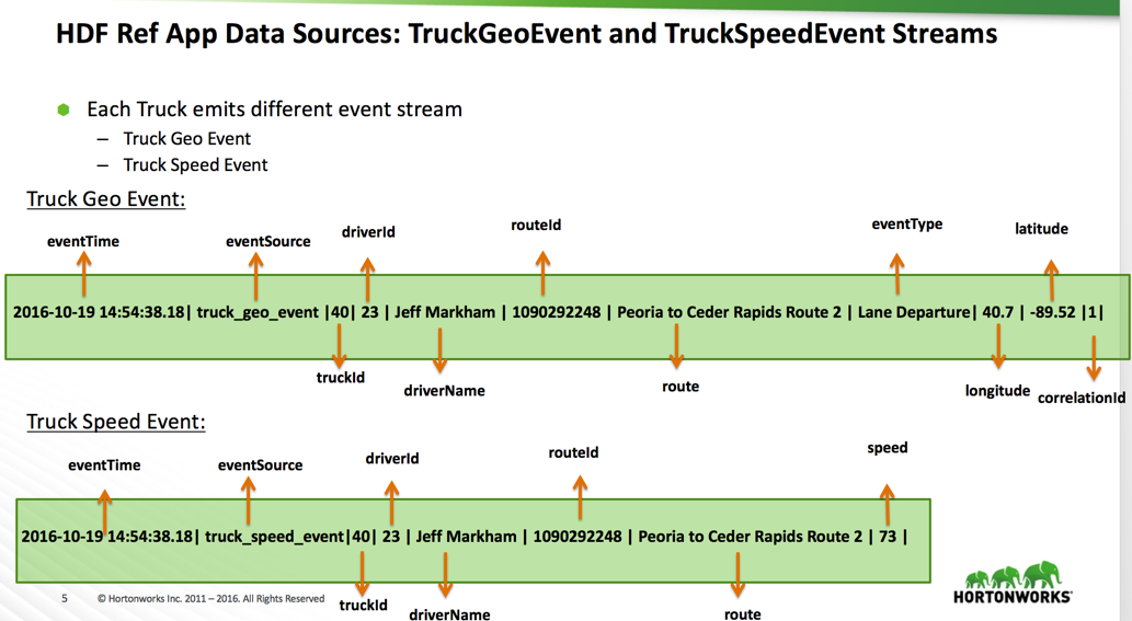

Data Producer Application Generates Events
The following is a sample of a raw truck event stream generated by the sensors.

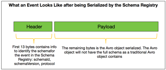

The date producing application or data simulator publishes these serialized Avro raw events into Kafka topics. The following is what the raw event looks like serialized into Avro using the Schema Registry.

The RecordReader and RecordWriter controller services are new controller services that allows you convert events from one type (json, xml, csv, Avro) to another (json, xml, csv, Avro). These controller services use the Schema Registry to fetch the schema for the event to do this conversion. There are a number of different schema access strategies you can configure on the RecordReader and RecordWriter to tell the Record Reader/Writer how to look up the schema information. For example, if you are reading records serialized by the Hortonworks Schema Registry, the schema identifier required to look up the schema in the registry is embedded in the header of the payload. Hence, the RecordReader would use the schema access strategy called "HWX Content-Encoded Schema Reference". The following are the RecordReader and RecordWriter controller services used for the NiFi template imported:

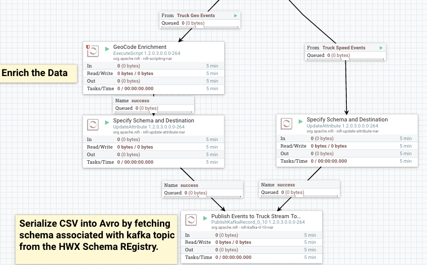

Publish Enriched Events to Kafka for Consumption by Analytics Applications
After NiFi has done the routing, transforms, and enrichment, NiFi will publish the enriched events into Kafka topics. These topics have a schema registered for it in the Schema Registry and we will store the schema identifier for the schema in the FlowFile attributes (UpdateAttribute processors) and use the PublishKafkaRecord processor to push the events into Kafka.

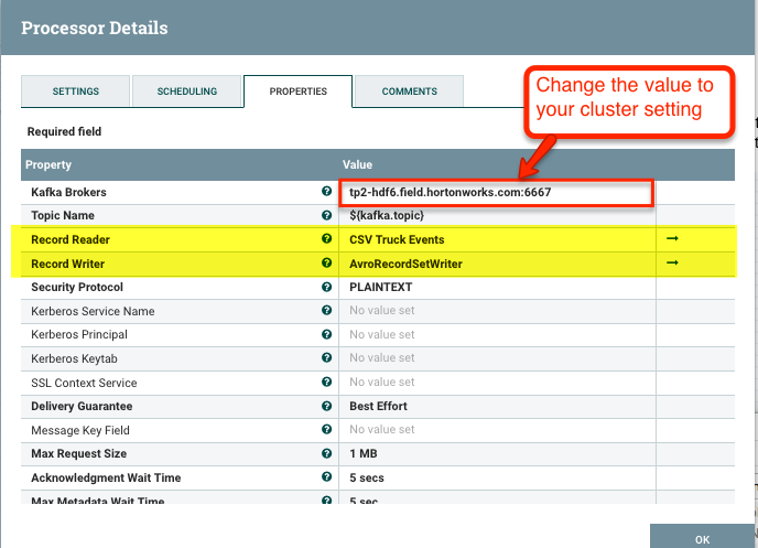

The PublishKafkaRecord processor is configured with the controller service 'CSV Truck Events' for the Record Reader and uses the AvroRecordSetWriter to write the events into Avro. It is a serialized Avro object with the schema identifier in the header that gets published to Kafka for consumption by SAM.
![]() | Note |
Make sure for the PublishKafkaRecord, you change the Kafka Brokers property value to your cluster settings. |
